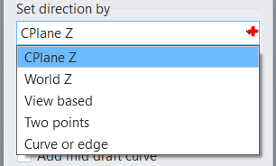

“Move the stripes with a widget” doesn’t tell me much. Did you try the “Direction” option?
This feature is still being worked on. I’m hoping to have something to talk about in a week or two. Our automatic announcement of feature fixes system kicked off when I had marked some of the items for zebra as fixed. I still need to do some tune ups to how the dialog works.

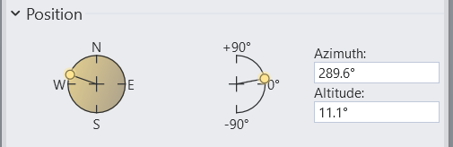

Wim, @stevebaer ,
What we need to define is a vector, so would be possible to implement this like the manual sun position setup?
Azimuth and Altitude may work.
Next to this also the same option available for the DraftAngleAnalisys would help in setup the desidered direction.

Currently the light line can be set by pushing the Direction button. There is no onscreen widget to move the light line around as shown in the video. This is something I’m trying to figure out how to implement in a way that is easy to work with.
