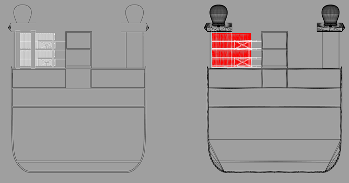

Hi Guys, here from the V6 next to latest wip, hidden lines are still wrongly interpreted:
(Make2D to the left, 3D to the ritght)
Holo,
Can you send in a file demonstrating the problem. I’ll get on it.
Greg
@GregArden, while on the topic, should I report cases of errors when using a ClippingPlane? I’ve not done so because it seems like anything with a clipped view produces errors.
my wip is messed up right now, but I think this file should give you the trouble.make2D wrong hidden.3dm (111.7 KB)
Thanks, put it here RH-31670
Please, post any bugs. The only major clipping plane issue I know about is that clipping planes never occlude objects they just cut away part of objects. This is the way clipping planes worked in V5 for make2d.

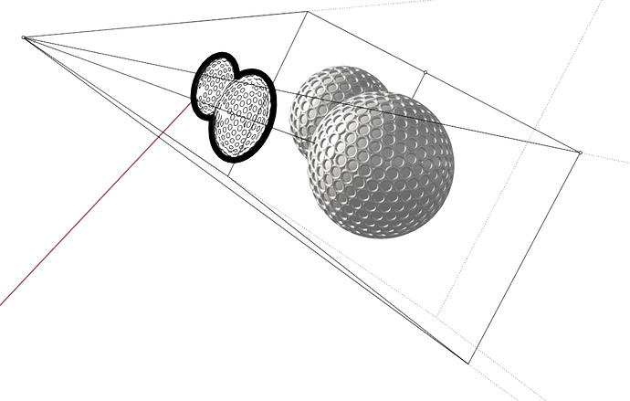

@rajaa Lots of fun here with silhouette on top of the beautiful new viewport options. I had one suggestion but maybe it should be a scripting suggestion and not a WIP suggestion. EDIT:Yep. Probably should be a script… I’m not sure how many people would use this :slight_smile:
Perhaps a toggle for Make2d would be, rather than placing the product at the origin, place it at the near clip plane of the current camera’s view. This is one step towards doing a full linework+raster workflow in rhino instead of having to composite in Illustrator or other. The second image is the camera shown in the first image.
Otherwise I’ve been playing (testing?) with meshes, surfaces, etc. Running so smooth and the results are looking great. Cheers!
@Alexander_Kaplan Got it. Will add to the list.
