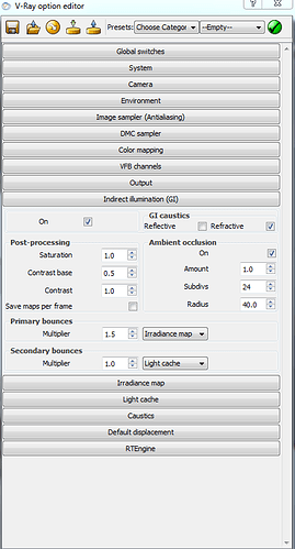

To be honest with you, i don’t “play” with the GI since a long time, got it right once and these settings have been working for the past dozens of images but if you can help me i’ll be grateful.

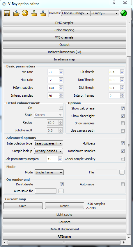

Primary bounce multplier 1.5? For a realistic look I would let it 1 and use secondary multiplier 0.8.
adaptive amount 1 makes a strong AO feeling, I prefer 0.6…0.8
use light cache for glossy rays speed up the calculation and enabled Retrace threshold could help to keep the quality at clean reflections (like at a mirror)
IM: color threshold - I would try 0.3 or 0.25

check sample visibility is the option against light leaks
Detail enhancement: brute force calculation at small geometric details helps to keep details

raytrace threshold, sample visibility, uncheck store direct light, detail enhancement, tried calculating it with brute force as secondary, and some other stuff i read, i’ve done the geometry again. nothing works.

Finally managed to correct it with extremely high IM settings. Detail enhancement, clr thresh, nrm thresh and interpolation frames. In fact I don’t know which one solved it and the rendering took forever.
One trick I forget - you can disable “use irradiance map” at the diffuse layer of any material and it will be rendered per brute force. So, you could apply a special BF material to the window frames only and get a slow detailed calculation there only.
