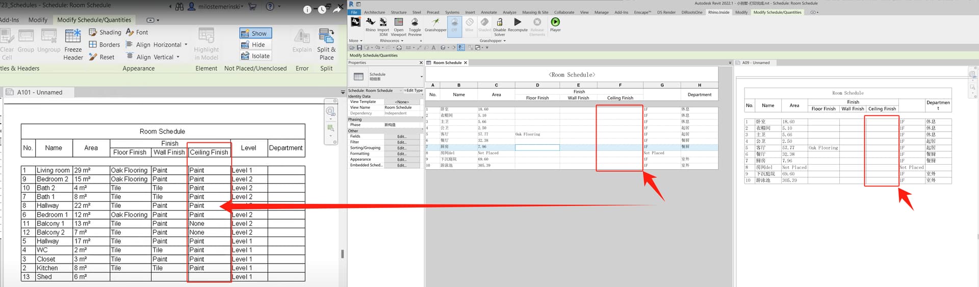

Hi JH_KIM,
When creating the Key it adds it as a parameter, which requires a Key as a Value input.
[image]
