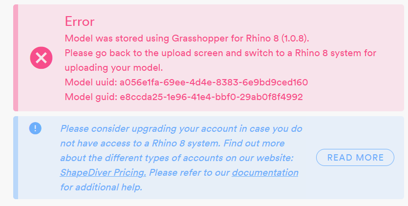

I’ve been testing my grasshopper definition for a little more than a month using Rhino 8 and it has been working nicely, it suddenly stopped working after enrolling in the developer program and keeps assuming I picked the Rhino 7 workflow.
I picked the Rhino 8 workflow on the upload page and changed the backend to use Rhino 8 but it still gives me this error, It also gives me a validation error but I don’t know if it’s related.
I just switched the default backend system for your organization to Rhino 8, could you please try again and let me know if the problem is fixed?
Yes it worked! thank you!
