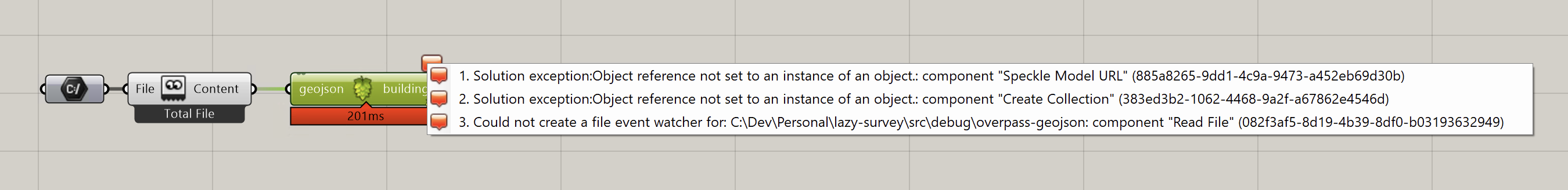

Hi Andy! I did some more debugging this week weekend. Some of those issues appear to be related to incompatible plugins. I’ve removed as many of those as I could and gone with alternatives that work or vanilla Grasshopper. These are my errors now (screenshot attached). I’ve also included my updated script below as well. Two of those errors seem to be Speckle related but I’ve read that it should work fine. See here. If you know what might be causing these issues, please let me know. I’m running rhino.compute on an Azure server and all the external plugins in this script are installed on the RhinoComputeUser account on that VM.
building.gh (25.4 KB)
I figured out the event watcher error. It just had to do with the Read File node not being supported. I was using internalized data in the Read File node as a default value. Then I’ve just removed Speckle from the process for now and I’ve asked their team if they understand why those errors might be there.
