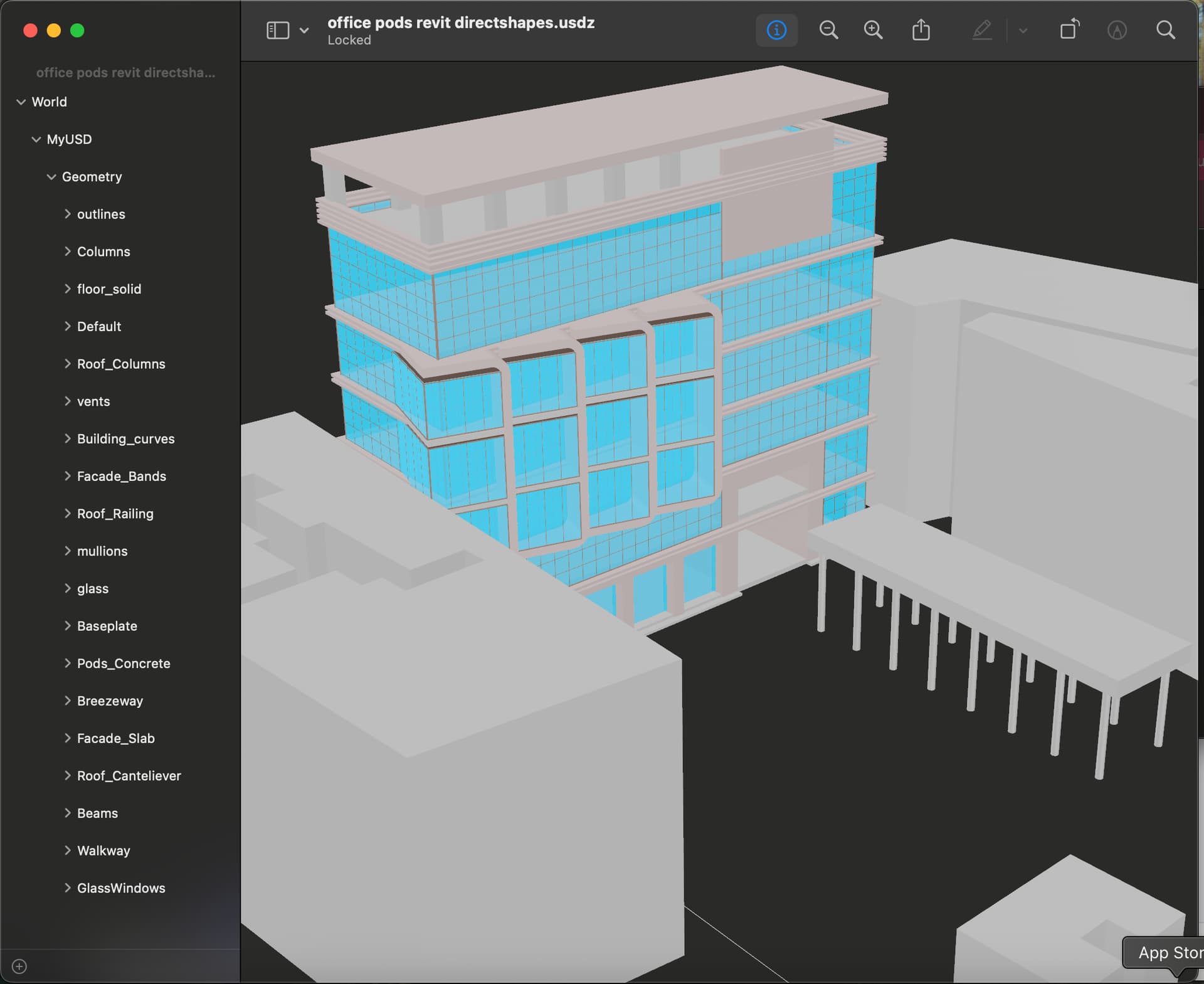

USD files can now be used to encode information for the exchange of BIM information to common workflows. Geometry, Layers, Blocks, UserData and Object Properties will now be transmitted into USD data.

  2. Included Userdata text on objects - Userdata can be used to add metadata to the prim objects in the USD file.
  3. Blocks exported - Block Instances are now exported in full. But also options with blocks can be saved.

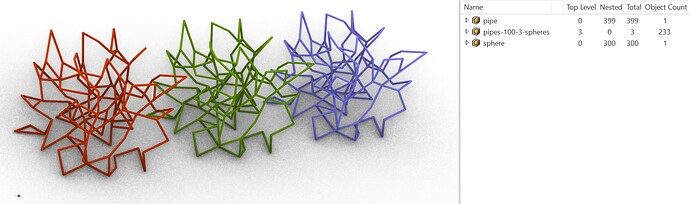

I’ve tried to export 25 identical blocks to a *.usdz file and it failed until I added a mesh box next to the blocks. Unfortunately I only see one of the blocks and not all instances.
Also the blocks actually contain breps and I’m unsure if I need to mesh the geometry before exporting.
Another issue seems to be whether a block is embedded or linked.
25 identical blocks should create 25 instances, but only one extra external file.

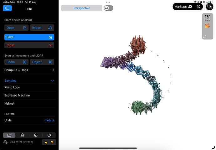

I opened the file in iRhino and all I see is a mesh box and one instance of my block.
This is my test file:
box and 25 blocks.3dm (222.4 KB)
And an export:
m6x50-cap.usdz (181.5 KB)
I see the issue with a pure block model. It does take an object in there.
