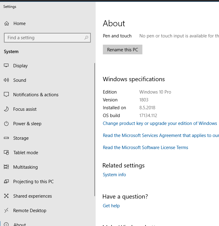

Can you paste a screencap of the About section where the Windows version info is available? Most specifically the OS build version.
Here’s About. UPloading immediately.

My guess would be the latest OS update, but we need more tests by others with this update to verify.

@John_Brock please note that win 10, 1803 has already many updates. You need to look at the os build version, as I explained with my screenshot.
1803 vs 1709 is a red herring - the wrong version numbers to look at.
It will be probably the most recent kb update that you and I don’t have yet
