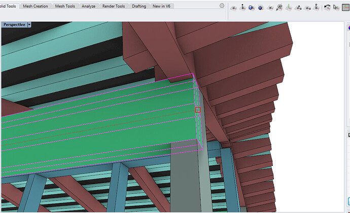

I have drawn a small wood shed but the further I got in the drawing I found more and more small errors. I realized this was the result of having used ExtrudeSrf at the end of some wood beams to make them longer. After doing that I used MergeAllFaces to get rid of the old isocurves. However, I still get snap on where the beam used to end, and also in the mid of the new extrusion and in the end of that. Since some beams were only one millimeter short I didn’t realize that I wasn’t snapping to the “old end” of my new and longer beam as I kept building.
I’m sure this is a noob pit that many of you have fallen in to. Hope you can share some wisdom on how to avoid this in the future. Thanks.

This problem could very well be a bug or poor software design decision done in Rhino 6 and has since been rectified. I am relatively new to Rhino so I’m not going to say anything bad about it yet. But extending one side of a box, perhaps many times, and then having to live with all the snap locations of previous geometry, that can only serve to cause havoc, seems very junior software development to me. I should have just used MoveFace instead. I learned that here today!
So what I did was simply that I used ExtrudeSrf at the end of a box… To make it look cleaner I used MergeAllSurfaces but that only cleans up the Isocurves, not the snap locations.

I opened it in 7 and there’s the same problem. I exploded the volume, rebuilt the surfaces and joined, which seems to work. ( I guess a screenshot is useless here)

In Rhino 6, MergeAllFaces will clean up coplanar faces and their edges but will leave old snap locations in place. In Rhino 7, MergeAllCoPlanarFaces doesn’t leave old snap locations in place.
When “MergeAllFaces geometry” from Rhino 6 is brought into Rhino 7, MergeAllCoPlanarFaces will not get rid of old snap locations. You need to rebuild the edges to clean those up.
