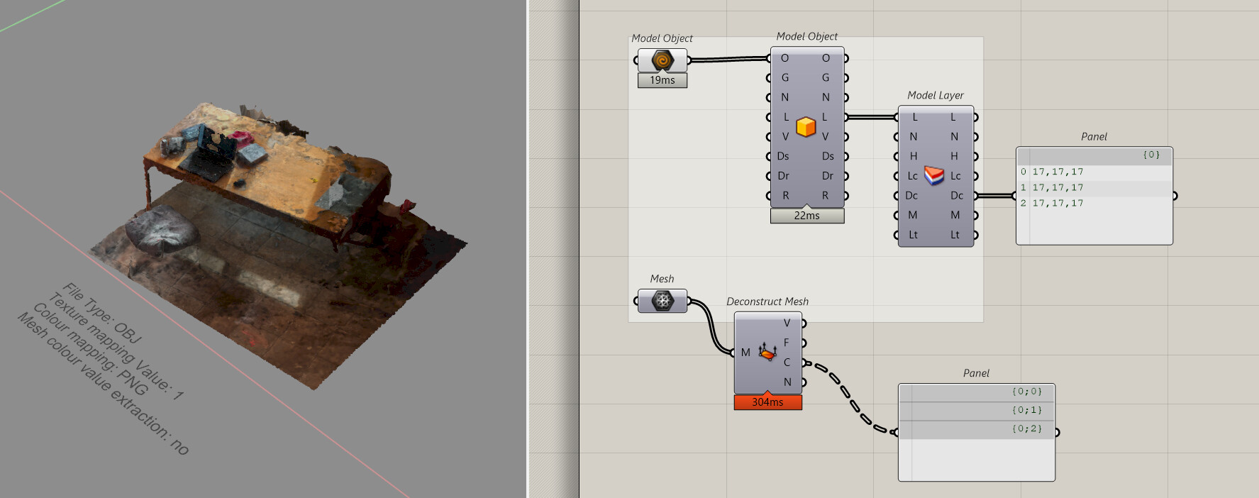

I’m playing around with some photogrammetry scans to try and extract some colour data from them to use in a separate workflow
I’m unable to retrieve the vertex or face colour data from the mesh in grasshopper after deconstructing the mesh.
I’ve been using Meshroom to generate the images into a mesh, and have been iterating through various export settings to try and get a better result but I haven’t had much luck there either.
Frustratingly I cannot upload the rhino file due the the file size limit - but I have internalized a small snippet of the mesh in the grasshopper file
Any assistance and guidance would be much appreciated :slight_smile:

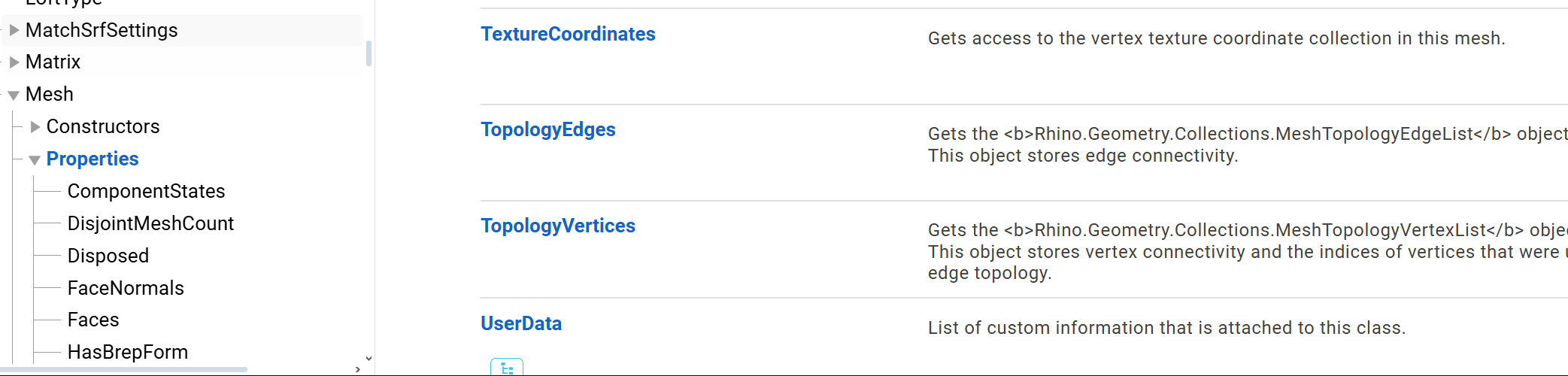

If you want to use just grasshopper, you can extract UV with C#/Python or plugin then use image sampler.
https://developer.rhino3d.com/api/rhinocommon/rhino.geometry.mesh#properties

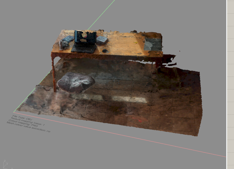

With this workflow I am trying to extract the colours of the mesh from the scan rather than applying a new colour to the input mesh

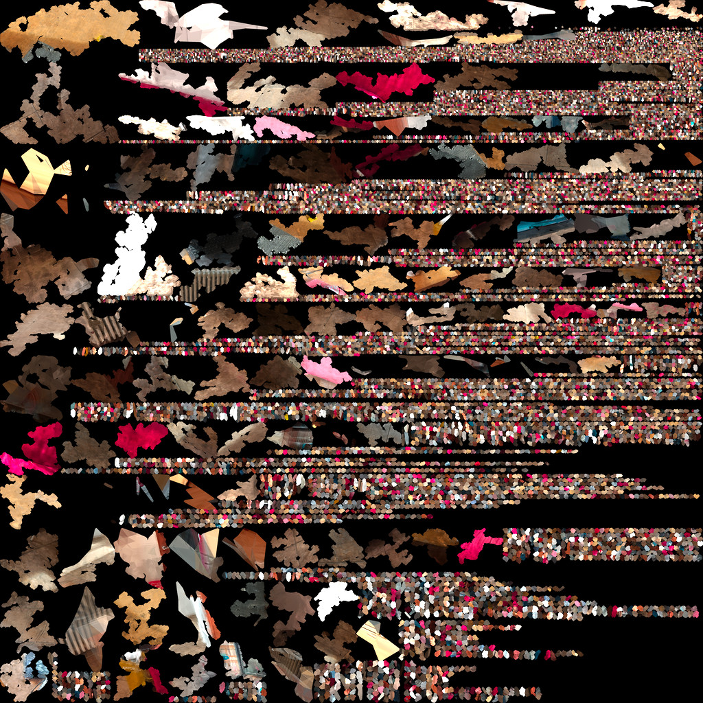

One of the outputs from the processing the images in Meshroom is some jpeg images of the mesh unrolled
But when i apply this to the mesh colouring the outcome is chaos… as we would expect
My goal is to get the color values from the textured mesh as shown below:

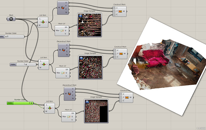

As advised by @martinsiegrist why not using computevertexcolor. It works ! And it will be more easy in Grasshopper.
In Grasshopper this is working as expected here, UV are all in range [0, 1]
I really don’t understand how you had some files with UV not in [0, 1] range !!!
Here a Grasshopper file
colour extraction tests LD_2.gh (6.6 MB)
You can also extract colors using UV coordinates and some index, here an attend but I was thinking UV were with range greater than [0 1] on X !!!
