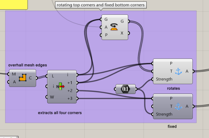

Hi @DanielPiker
I’ve tried to modify the file you gave me to fit my definition, but there is something that I’m doing wrong.
Starting from this
I divided the two sets of rectangles that i have on my facade
in the right part i selected the points that i want to rotate and the ones to remain fixed
I noticed that in the output i get these “invalid lines”
What am I missing?
