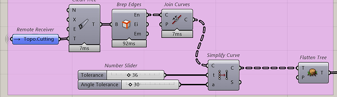

Although, just simplifying the initial curves still comes really close in terms of speed and reduced vertices while keeping the same basic shape of the curve:

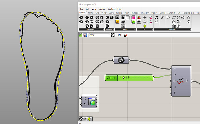

Would it be possible to have a 2D shrinkwrap around a chaotic set of curves with some kind of relaxation ? That is what I have been trying to achieve but depending on the number of control points on my rebuild curve I got good or bad result (see image attached).
Is there a better / more robust way to get good result each time? The goal is to get a streamlined automatic script to create custom-made flip-flop.
Definition FOOT.gh attached.
FOOT.gh (44.8 KB)

Here’s a way to shrink wrap the curve using the standard shrinkwrap component and no plugins.
Not convinced you won’t have to tweak the settings on a foot-by-foot basis though.
Another FOOT.gh (55.2 KB)
