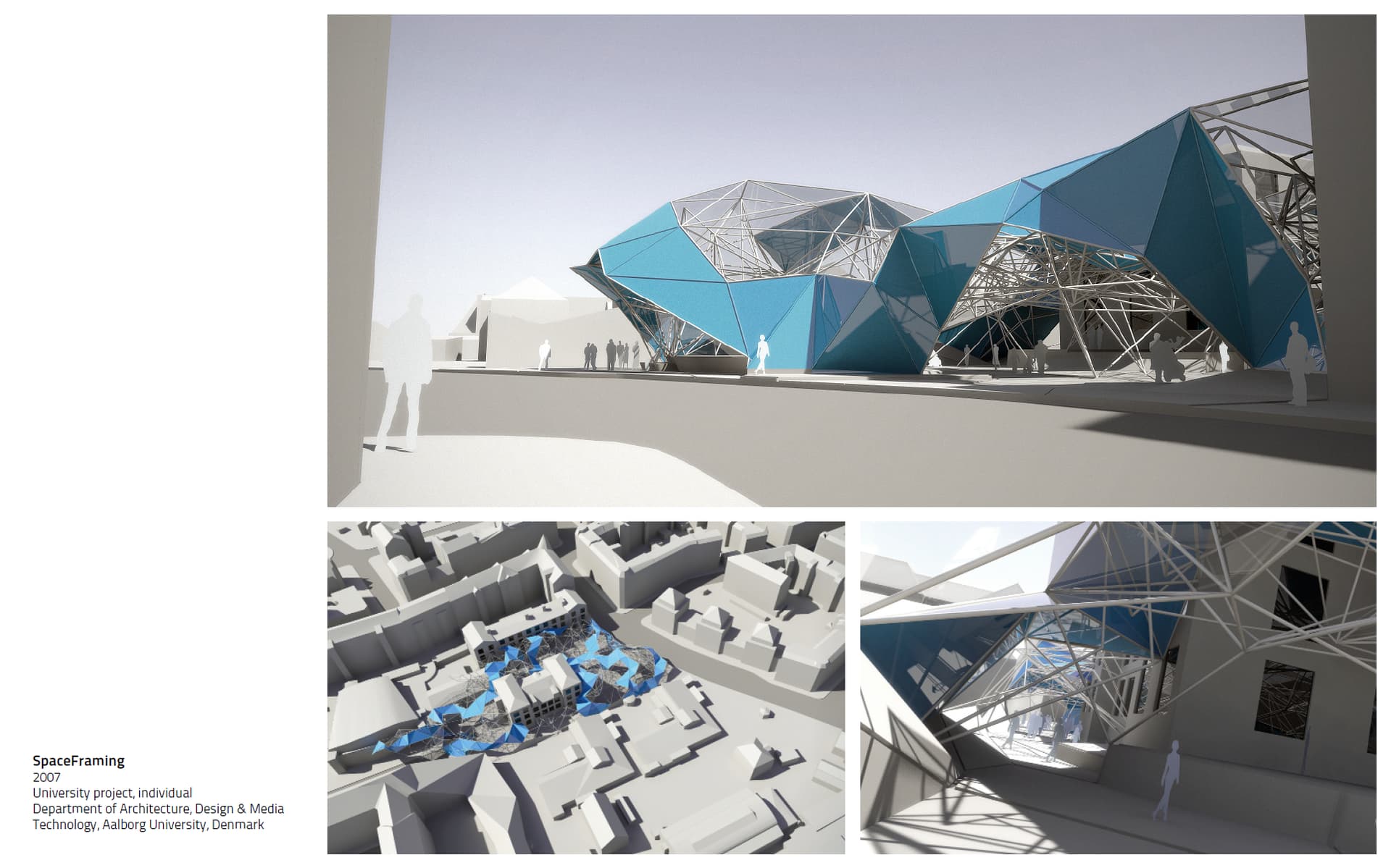

Hi! I’m a begginer with grasshopper and would like to recreate this project from Uni and dont know how to begin (tried creating random points within a similar shape then triangulatinf them but didnt work) Any suggestions on how to begin? It doesnt need to be exactly as the fotos but a similar thing

Whoo, this brings back memories. I did a similar project back in 2007 using Maya for all the modelling. Peak Mental Ray physical sky look too, what a time to be alive :older_man:
The geometry generation was quite close to what Peter describes:
  1. Generate point distribution within site envelope. I used the Nucleus physics engine for this to repel particles and get an even distribution. One could use Kangaroo for this or maybe simply Populate3D.
  2. Connect points by proximity and cull/add elements manually. This was done using a Maya MEL script.
  3. Generate triangulated enclosure.This was also scripted in MEL script by first drawing one triangle and then searching closest points from this and doing basically mesh walks on a point cloud.
That is, not really informed by environmental or structural analysis information. Which I’d definitely be driving such design by today :wink:
