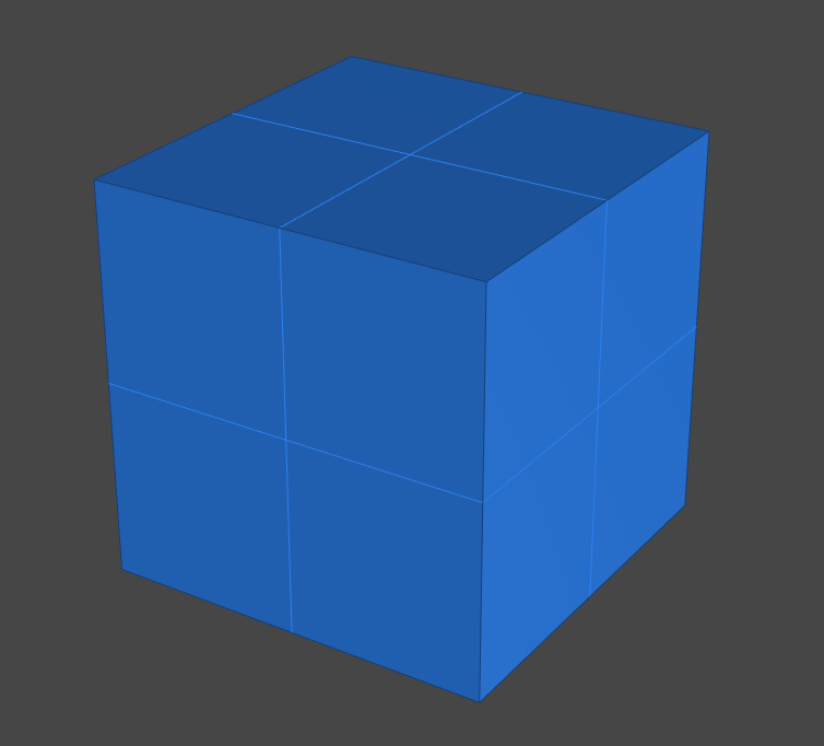

Hmm, in my shaded mode I have edge color reduction on (50%). When I do a ViewCaptureToFile, I get the edges going transparent… Also if I have a ClippingPlane with edges on, those go transparent too.
Rhino VP:
Photoshop:

Ya, that’s what I’m doing…and I have my edge reduction set to 50% … What does your capture dialog show? Are the wires transparent there too?
Here’s what I see…
Here’s what I see… Yes, the edges are transparent in the preview already…
My background is gray 70,70,70.

Here ya go…
JeffsCube.3dm (337.1 KB)
Shaded.ini (11.9 KB)
As I said, viewport background 70 gray, but I don’t think it actually matters in this case.
