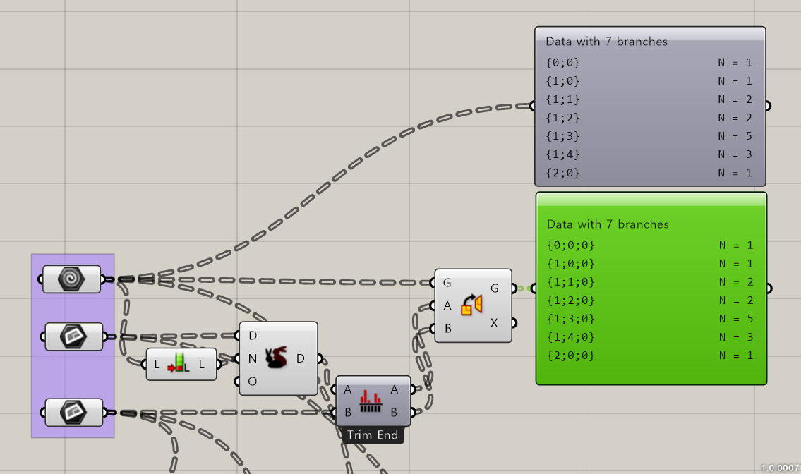

I have sth like this:
I want place breps from each branch using each plane corresponding to branch. But it doesnt work it places only once one of them ( from 1;1) and then only second from the same branch is considered. It turns out that trees are far away from programming launguages collectitons concept :sweat_smile:

You can use Group and Ungroup.(Transform–>Util–>Group)
Or you can duplicate your plane based on the list length of your geometries per branch using Duplicate Data.

It seems the problem is your target planes.
They are randomly distributed and have larger numbers per branch than your objects.

Really appreciate your help and it is bit closer but look that those breps are on one branch but put around separately - those should be like branch == group and put each group on from branch plane to target branch planes - don’t know if that makes sense to you.
Basicaly what i do and why this is in branches i use c# to retrieve block as a whole then operate on those to see whats going on and finaly compound xforms to bake blocks according to made xforms.
Yep i guess v3 will do the work however data duplication gives me tons of unecessery xforms but ill try to reverse it later or just do separate operation to get not displayed data.
My bad. In this case, no need Duplicate Data or Repeat Data.
BranchTransform_reV4.gh (47.3 KB)
And thats it ? :smiley: Thank you @HS_Kim very much for your time!
