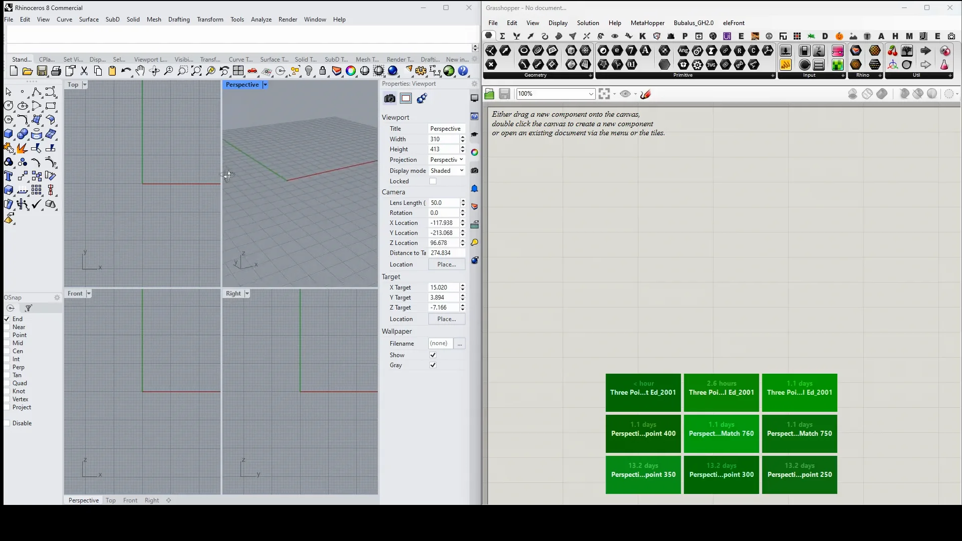

Although Rhino isn’t primarily designed for photomodeling, I challenged myself to create a Perspective Match definition in Grasshopper. The main obstacle in modeling accurately from a matched image in Rhino is the inability to zoom or pan in a locked viewport, as the camera can’t shift in the X and Y directions. Despite this limitation, I developed a Grasshopper definition that can match an image to a 3D model, similar to software like fSpy.
Overview of the Process
  1. Loading the Image
    First, the image is loaded onto the XY plane in Top View. Using sliders, the image can be positioned outside the workspace.
  2. Setting up an Axis System
    To define the model in 3D, an axis system must be established. Axes are placed on the model; they don’t need to pass through the anchor point, as the definition adjusts this later. The angles between the axes don’t need to be orthogonal if a different setup better fits the model (e.g., for an irregular structure like the Pentagon). An anchor point is placed to mark a reference point shared by both the image and the model.
  3. Initial Camera Positioning
    Position the camera relative to the model to approximate the camera position in the image. This initial match aligns the control lines (used to construct the vanishing triangle) for better positioning.
  4. Constructing the Vanishing Triangle
    Control lines are aligned parallel to each chosen axis and color-coded. In three-point perspective, parallel lines converge at a single point, forming the vanishing triangle. Grasshopper then aligns the model with the image based on this triangle. For cases with camera shift, the definition can create an extended image frame, centering the principal point. This modified image can be saved as a wallpaper, paired with a saved view in Rhino.

Hi
Can you show an example about this problem?
In my first post I posted a definition that I want change for a new one, because there is something wrong with it, But I can’t edit my first post.
It’s the definition with three pairs of control lines. I had a Boolean on true (the perspective camera), that must be false when starting this definition:
Again:
Three Point Perspective Match 3ctrl Ed_2001.gh (586.2 KB)
Yes:
I cropped this image:
perspective matched:
So I edit the image with GIMP:
and send that to camera:
The results of ‘View Image’ are really weird sometimes. But without this component, this definition was not possible.
With this crop I wanted to test with a big camerashift. That is handled well. That’s why the image off-center. But the principal point is in the center of the viewport.That’s how it should be.
The image loaded as it is , in which part of the script you get this wrong orientation?
The script is good. It is the component that sometimes does not handle an image well when the image is at a certain angle (in 3D).
My second definition was also posted with the boolean for the perspective camera on true, so also a new upload:
Three Point Perspective Match 2ctrl_principal_point Ed_2001.gh (579.7 KB)
You changed the input plane and the image looks rotated?
Or in your script you orient the imported image to a new boundary?
Please look at my first image in the first post, you can see in the Front and Right Viewport that the image is placed in front of the camera.
I checked the other view image component.
You have an issue with the input plane when using Orient; please check and fix it.
The image view is just a tool to display the image based on the input plane and has no effect on the result even you remove it from the script you get the same wrong image orientation.
The orient component does what it is supposed to do, the problem with the ‘View Image’ is not in my script, but in the component itself. Look at the example I give and see that there is a very strange rotation within the image itself.
The orient component puts the plane exactly where it should be.
Just remove it from the script to understand better.
The problem is with orient process, you need to check the input plane and fix X,Y directions
Here is a video of the matching proces with three pairs of contole lines:
