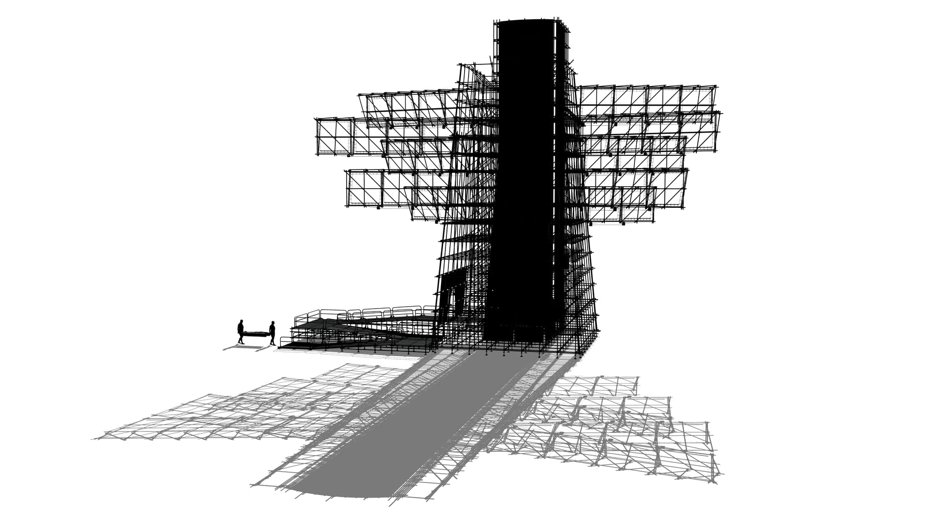

Here’s the sort of viewport capture I extract to layer up and overpaint:
(This is a custom “false color” viewport display mode destined to produce masks in Photoshop.)
(This is a customized viewport display mode I whipped up, something like Arctic but with materials.)
(Rendered Display Mode, with transparent materials visible in the model)
(…the same as above, but with all items having transparent materials turned off, no change in lighting or shadow settings)
I’ve noticed some odd issues with Viewport Captures that make this technique more painful that it should be. Under some circumstances, the Capture Viewport to File tool doesn’t seem to capture what is on the screen. This seems to have something to do with the resolution of the capture, as the first cause: I generally want the smallest dimension of a capture to be quite large, 5K or 6K pixels, so that I can shrink the image down in Photoshop to minimize the jaggies caused by the limitations of Rhino’s on-screen antialiasing. But if I grab a viewport with shadows, and I specify a pixel height for the capture over 4K, the shadows will not capture properly. Some parts of the shadows will not show at all (it is falling on an active but shadow-only Ground Plane), or there may be a much lighter “chunk” in it. Even at 4K pixels in height, which is what you see above, the shadow in the Rendered viewport I used with this image is captured as much lighter than what I want and than what I see on my screen…unless I turn off or hide every object in the model that has a transparent or translucent material applied, either by layer or to the object alone. It’s frustrating…no amount of playing with Shadows category in the Display Options settings changes the issue. I have to fix it in Photoshop.
