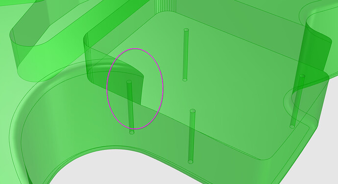

Next is the neck screw placements… These are not standard… Well, one of them is not where it’s supposed to be… This means a bit of changes to the body later when the rest fits… Still unsure how to measure this correctly…

  • Finally found the issues with separating the bottom place from the screw holes - silly part where common tools wouldnt work… Explode and cull the wrong parts helped! Twisted solution that wont work if i change the body at any stage! :frowning:
  • fixed the wrong angle issue in body-neck interface. Body was not sized up (by 1.0009) like the factor of change between the new neck Y size (56 instead of 55mm) - body curves were not adjusted for this and it created a gap/undulation and an angled wall with the body. This was tortuous to find jumping between the neck group, the guitar body shaper, and duely documenting this issue once you introduce a new part into the model!

Neck holes for the screws that hold on the neck to the guitar body are a bit off… Still by .5mms here and 1-2mms there… Trying to make an accurate gauge/template to find the right pattern… Took 1 week but finally realized I have transparent plexiglass sheets to do this with! And I rewrote the module that was just overly complicated.

But I got to work on the reference surface before I get to that… It’s a 3-2-1 step approach. With my usual cnc stuff, i just cut and see. Here, I have to make sure it fits before I cut!
First issue I found with my previous approach is that my screw positions for flipping depend on the distance to the edge of the block. Not that of the “waste board” reference. So, a new step/level/layer/etc incoming…
