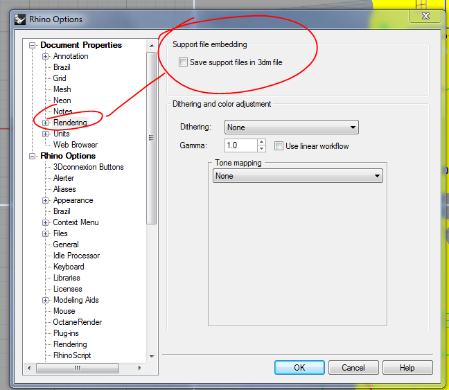

Can you post the file as well as the texture please or embed it before saving in Options>Doc Props>Rendering? Also let us know what rendering engine (if something other than the default Rhino Render) you are using, this can effect the rendered display mode.
