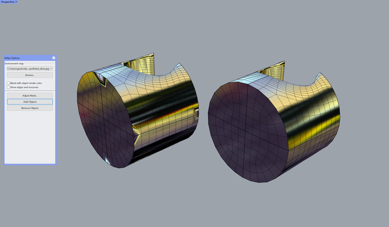

I was using QuadRemesher with generally good results, but some parts have this issue with shading which I can’t get rid of. Mesh Repair doesn’t show any issues.
Shading stays bad after exporting to other programs too.
quad remesh part.3dm (1.5 MB)
Hi Jakub,
Running _RebuildMeshNormals seems to fix it?
here’s before/after side-by-side:
Best,
G
Yup, it helped, I forgot to check this option too, still learning about the meshes.
Thanks a lot.
