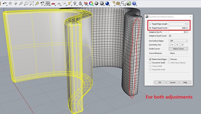

Just this case. The desired edge length is too large to generate the appropriate loops around the holes.
