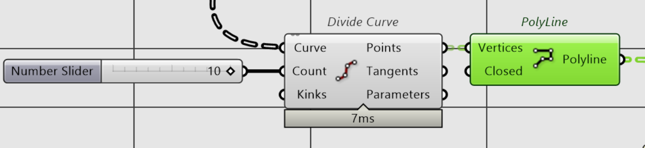

Hi, Tekla doesn’t work with a curve geometry and rebuild it any time to the polyline geometry. Easiest way → change it into polyline in GR, thanks for that you will have a full control about geometry.
Yes, but even with polyllines, some rebars groups were still deviating. Can you share the script?
I didn’t save it, sorry. Also 1 think can be - Tekla has a problem with elements, that have a long distance from model 0,0,0. Move it closer to 0, it can be just representation problem (I did it also for screenshot)
