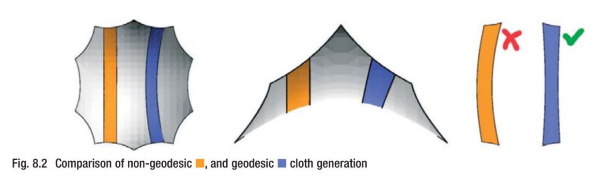

Imagine a doubly curved surface. Imagine 4 individual points. If you connect them 2 by 2 with geodesic lines, then the geodesics follow the shortest path on the surface… which is not a straight line. This is why the width between them is non-uniform. This is why I suggested to test it out with section cuts, because then you can have some control over the uniformity.
As you can see in my image, you can have geodesics which are curved in 3d but relatevely straight in 2d or section cuts which are straight in 3d but curved in 2d. I know of no method in which you can have both.
My question is do you plan to do this in the real world or it is just a model? If you do plan to do it, then I suggest the following approach. Pannel the surface using geodesics. Make sure your pannels are a bit smaller than the width of your tape. Flattem then in 2d. Then print the resulting strips in 1:1 scale. Cut out the patterns out of your tape and you are good to go. No wrinkles what so ever :slight_smile:
