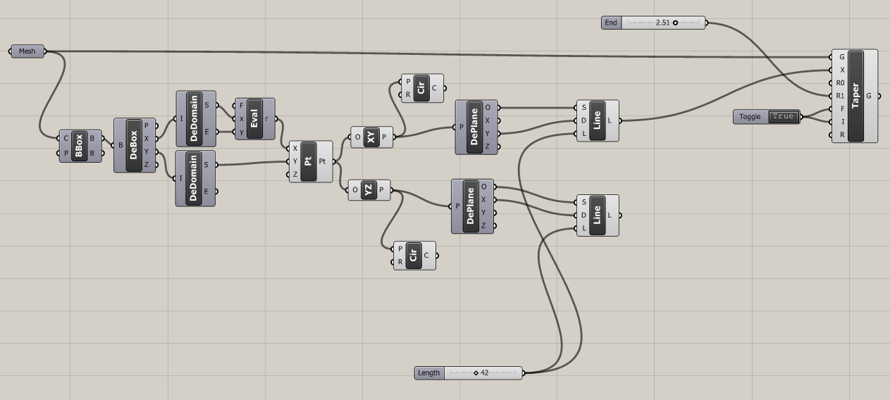

i made some tests with a referenced mesh box which was moved outside the world center. then i used a bounding box and a point component to put the start of the taper axis where i think it should be and attached a worldXY-plane and a worldYZ-plane to this start point (the planes are visualised via circles). at last i generated axes from these two different planes and used these axes for the taper. allthough the two axes are in two different planes, they give the same result (THE TAPERING SHOULD BE VISIBLE IN TOP VIEW, top and bottom of the meshbox should stay parallel to worldXY, the two smaller sides should stay parallel to worldXZ)

altering the length of the taper axis changes the tapering strength, even though “infinite” is set to true (mouseover says: “If true, the deformation happens throughout the geometry, even if the axis is shorter. If false, the deformation takes place only the length of the axis.”)

in my previous reply I used XY YZ XZ planes because your method for generating the taper axis was using base planes
but an axis is just a line, so whatever method you use to generate it, will always be ok
of course, two identycal lines -despite being generated in different ways- will produce exaclty the same result
