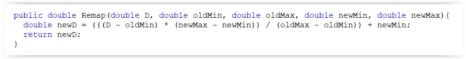

Are you sure your function is correct ?
In order to use Sweep2 you need to actually build the curve, that is construct some points using X and Y coordinates.
However the values are in the 10^13 range… (tried in mm and in m)
After double NaN and posInfinity checks use:
There is either a problem in units, or a problem with the formula.
But assuming x in in meters, the first term of the polynomial is about 10^(-6)(10²)^5 = 10^4 whereas the second term is 10^4(10²)^4 = 10^12.
I tried with 10^(-4) as the coefficient but I get almost a straight line.

For a sweep to work properly, it’s best if the section and the curve intersect at one point. However I see here your Grade 4 curve starts on top.
So actually instead of removing the constant term, you should calculate it so it makes the rail match with the section curve.
Don’t know if there is a problem in the csv but there are lines with a single coordinate and this makes an overlapping section.
Finally, if you want to repeat your sweep operation on multiple couples of rails/sections, you’ll need data trees. Using Entwine here seems to do the job.
