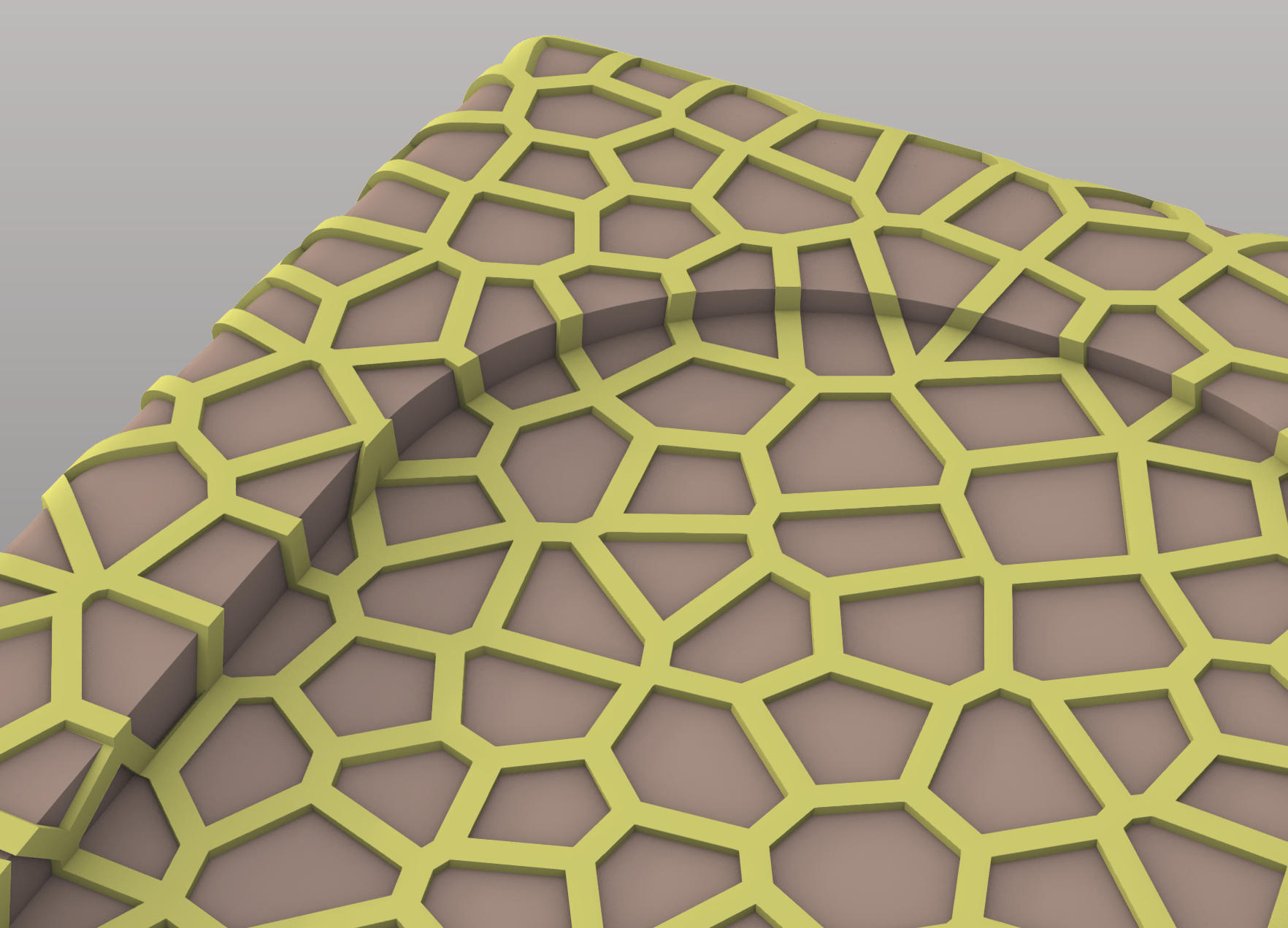

I have created plane voronoi cells extrusion on a source planar surface and want to map them to a surface that is simply connected (with a hole in the middle). I replicated the steps in several tutorials, but when I surface morph the cells onto this surface, the boundaries of the surface are not respected and the hole in the middle is also populated while it should not. You can see that in the screenshot below, the surface is in yellow (and symmetric about the clipping plane), and is on the inner side of the model.
While the pattern extending in the middle section is the biggest problem, I have remarked , by applying the workflow to other surfaces of the model as well, that the boundaries of the surface are never respected. The morph always extends rectangularly outside the surface.

This is just a guess, but it looks like you have been caught on the obscure issue of “surface extents”. This means that if you create a surface, and then trim it in some way to reduce it’s size or change it’s shape, the real internal definition of the surface is NOT changed - only the displayed version is. So if you do something like a morph function on what you think is the trimmed/reduced surface that you see on screen, the morph results will actually happen to the original, unshrunk version.

The (sort of) good news about this is there are routines that shrink the internal version of the surface definition down to what it appears like on screen. I remember someone here wrote a very short C script to do exactly that. There is a Rhino command that does it, which is what the C script calls - but I don’t use Rhino so I can’t tell you what the command is. I’m sure someone else here will add the missing detail - or correct me if I’m all wrong.

Elaborating on what @Birk_Binnard has already written. A trimmed surface has two parts: a surface that underlies everything that defines the geometric shape, and trimming curves that either trim away the outside portion of the surface or cut holes in its interior. The Surface Morph component operates on the underlying untrimmed surface. You can alter the U and V inputs to the Surface Morph component to change the extents of the underlying surface that is used to perform the morphing operation (this allows some scaling of the resulting geometry).
The geometry in your file can be used to construct “cutters” that can be used with split/trim/boolean operations to eliminate the portions of the Surface Morph result that you do not want.
I think this is the result you’re looking for.

I Think I understand what you are doing. You are lofting the outer and inner curves to create solid cutters, then trim the surface morph with them right? On the .3dm I upoaded my problem is that the extrusion is the wrong way (should go inward) and changing the surface morph W domain to -1 changes the solid cutter box but not the actual extrusion.

Here’s a solution using a different workflow that produces your desired result (I think).
  1. Join the surfaces from your source geometry. This creates 2 closed breps with normals facing outward.
  2. Flip the brep representing the inside surface of your object so it’s normals face inward.
  3. Merge the inner and outer breps to create a “Hollow Solid”.
  4. Use this “Hollow Solid” to generate a 3D Voronoi.
  5. Enlarge the boundary used to generate the Voronoi to elimate errors later with boolean operations.
  6. Offset the voronoi cells inward to make cutters for solid boolean operations.
  7. Subtract cutters from “Hollow Solid” created in step 3.
The whole operation takes a couple of minutes with 500 voronoi cells.
