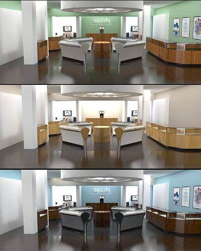

Here is a picture of a project I completed with wood maps made in Filter Forge:
