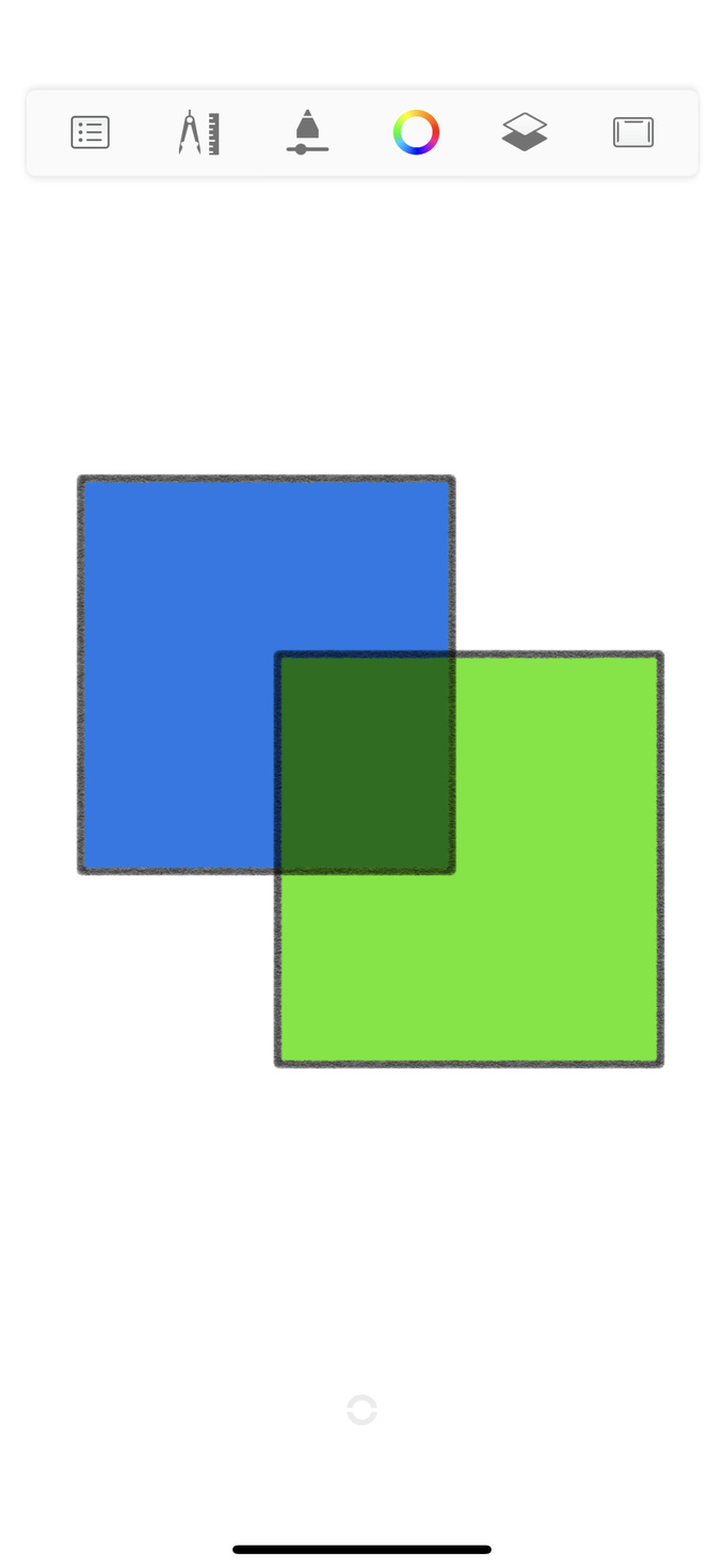

  • can you detect if coincident faces with the clipping plane are overlapping? Like this:
Thanks,
G
