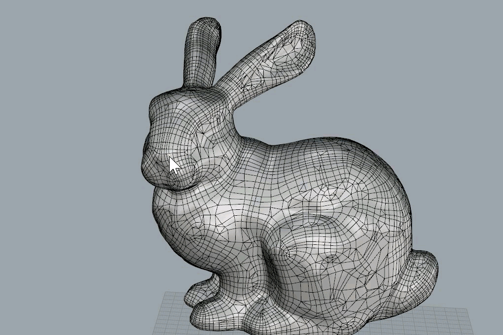

Subobject selection vs Object selection -- SubD -- selection extensions
With the new SubD object in Rhino, selecting, transforming and editing parts of an object by adding/removing faces and new edges (let’s call this “subediting”) become fundamental parts of the modeling process. We are excited to study how subediting should work. While we are at it, it will be great if these methods will work at least also on meshes, and where applicable on polysurfaces.
The first part of this is to improve the selection mechanism so that it is intuitive and easy to access, is coherent between different object types and is as non-disruptive for existing users as possible. Of course, these goals are somehow conflicting.
So, we would like to know your opinion and improve our current selection toolset based on your experience, also with other programs. Let’s start with what we have today around selection…

In Rhino WIP, there is an Object/Subobject switch in the Selection filter toolbar.

1) Object/Subobject button for mode toggling
[Object] / [Subobject]
A button that switches between the two. It would be similar to the half-filled checkbox in the current Selection Filter in the WIP, but more visible, maybe on the status bar.
2) Object/Subobject keyboard key shortcut.
Rather than keeping Ctrl+Shift pressed, it could be possible to use a key combination to switch between the two selection methods.
This shortcut could even be the current Ctrl+Shift: as soon as it is pressed, it could toggle the button above(?)
3) A subobject selection MODE that is pickier:
[Objects] / [Faces] / [Edges] / [Vertices]
One keyboard key could switch between each. This might be visible on the status bar.
4) A Rhino toolbar to make current filters work like method 3:
If I click [Objects], then the current selection filter will pick whole objects and no subobjects.
If I pick [Faces], then subobjects are used with faces and remaining checkboxes are unchecked.
If I pick [Edges],then subobjects are used with edges and remaining checkboxes are unchecked.
The current toolbar instrumentation could be improved, and if checkboxes are aligned with the prescriptions of the table above, the button might look “pushed down”.
5) Changing highlight color for subjection selection to a special color that is by default different than the one for whole objects. Maybe light green could work.
This would make it easier to recognize when a subobject is selected rather than a whole object.
