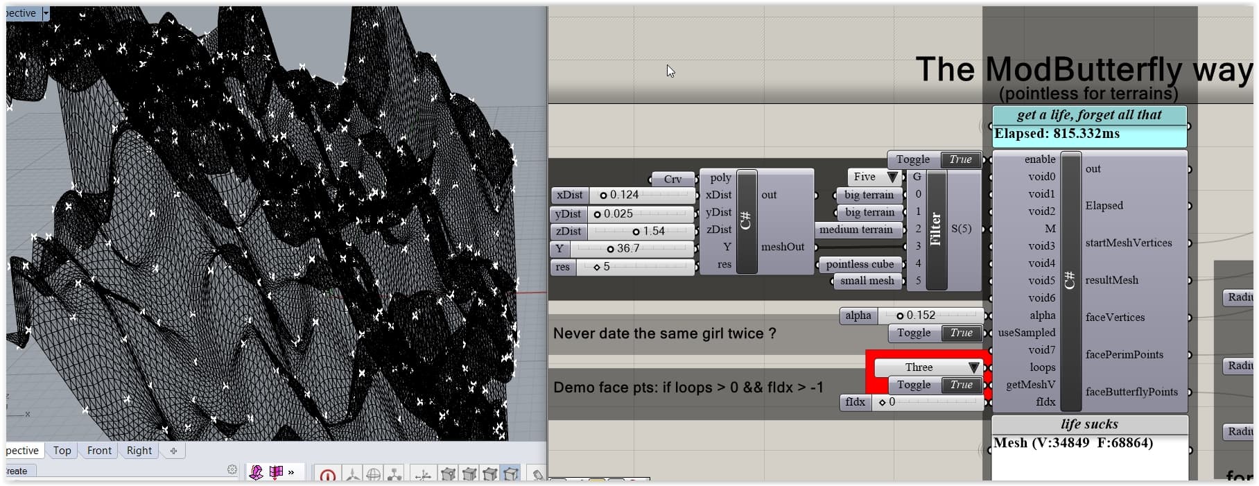

Works here:
Thank you for te detailed reply! Not sure I understood correctly, but the last two screenshots depict a version that uses a custom made C# component that actually does what I was looking for? And if so, could you share it?
It works on closed volume meshes only, that’s what I was missing, thanks!
But that C# keeps (as an option) only the naked Vertices intact/fixed. You said that you want all the Vertices fixed. That said if I was you I would rather search/exploit ways to convert the Mesh into a Nurbs Surface/Solid (I hate working with Meshes for AEC purposes not to mention that you can’t see a thing or two when you are in Wireframe mode).
On the other hand implementing in a C# the Butterfly approach is a 15 minutes job (the only thing required is a knowledge on Mesh Connectivity: FE/EV etc … plus some elementary List (of type int) Intersections - see Stanford d 5/6/7/8 Vertices).
Update: Finally that thing required 22 minutes:
Still I can hardly see the point for terrains.
Update: added some things more (for dealing with open meshes) according to Zorin
Butterfly_Zorin_interpolation.pdf (1.3 MB)
