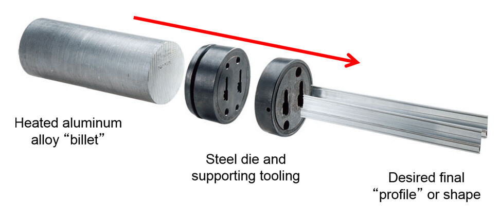

How are these cases made?
Extrusion of hot metal with a cookie cutter cone?
Looks like it’s made from one piece (holes cnc’ed after I suppose).
Im at a lack of words here to google anything significant.

Edited: oh, sorry, 2:33 am, woke up to see this with dim phone screen, I see this wrong. Extrusion is right.
Hi @xavier.bury
That is indeed an aluminium extrusion - and yes, the holes in the flanges are machined after extrusion.

Not sheet metal.
I’d guess an extrusion process.
That’s an aluminum extrusion - here’s a good description with more details on the process
Pressed Sheet metal this would require separate parts top and bottom (This has a name too - which escapes me).
