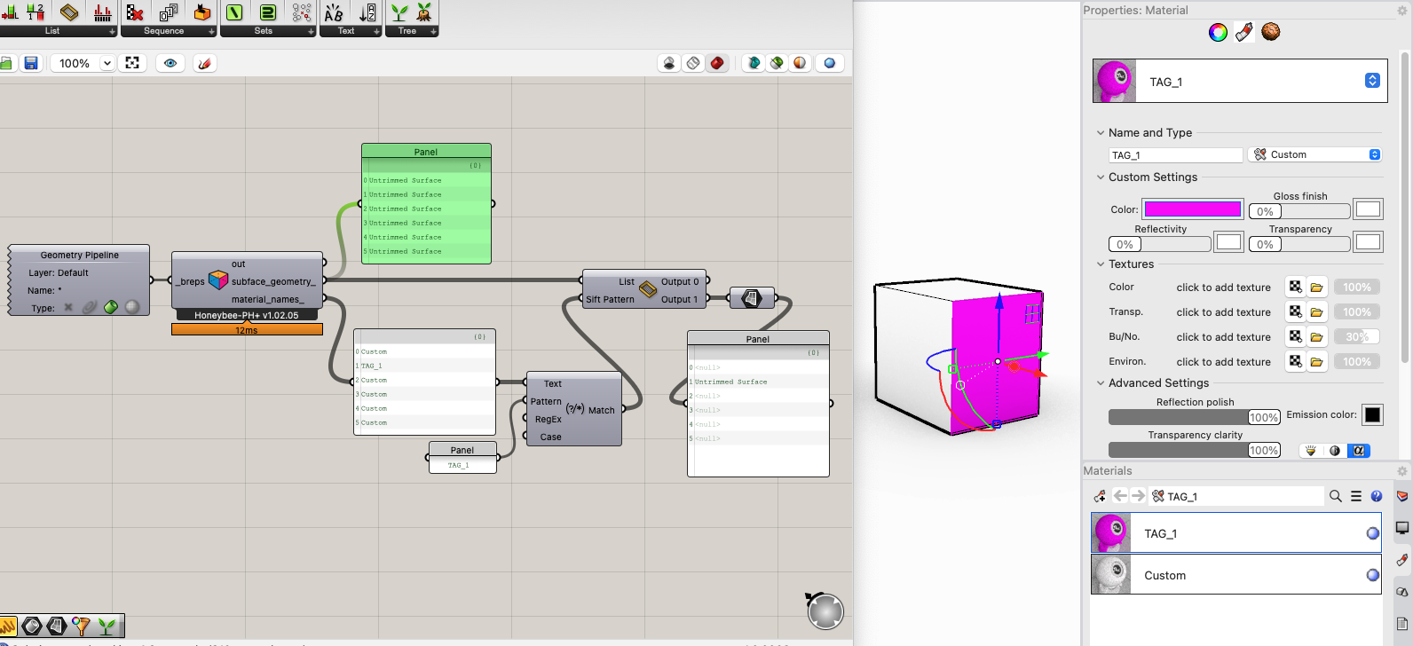

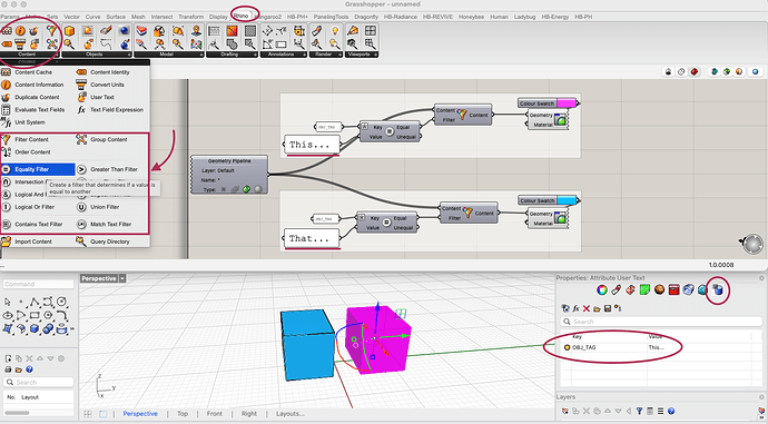

Any favorite strategies or rules of thumb on how people select geometry?
FWIW: I’m a big fan of ‘Pipeline’ components, combined with filtering to select the ‘right’ objects for GH scripts. In RH8, there are now a nice set of ‘Filtering’ components which work quite well for us when combined with UserText tags applied to objects in Rhino:
By ‘tagging’ objects in RH you can then usually control their selection in GH reasonably well. Though of course it would be nice if the ‘tags’ where a bit more user-friendly, as discussed previously
However for sub-face selection on Polysurfaces, the best workaround we’ve found (since you cannot ‘tag’ sub-faces using the existing Rhino UI tools - though it is possible with custom scripts) is to use Materials as a proxy for the ‘tag’, and then filter / sort based on the Material’s name over in Grasshopper. You can easily apply different materials to different sub-faces of a single Polysurface, and so in this way determine ‘which is which’ within GH:
You get the added benefit of ‘seeing’ which faces have which ‘tags’ applied as well.
I’m not 100% sure if this something that can be achieved with the ‘standard’ GH components? We just created a small utility component to pull that data in though, which has worked quite well for our needs.

@ed.p.may
Example Files:
Thank you Ed. :slightly_smiling_face:
I like the R8 components and use the filters. I saw the tagging with materials mentioned somewhere else, but couldn’t quite figure it out, this might be a help.
