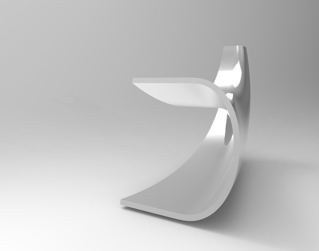

Here’s a typical render of the horn I did a few weeks ago from my original Rhino model - no problem:
Now I’ve remodelled it in T-Splines:
It works fine:

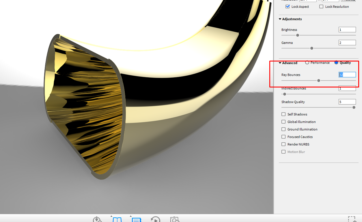

until I add a reflective material and then it all goes a bit odd - the annoying thing is that it happens with both models and no amount of tweaking or turning everything up to 11 makes a difference:

Any idea why this is happening?
I suspect this is due to the way keyshot is interpreting the normals.
Can you convert the shape into a mesh and does that act the same?
Did i read correct that this is only with the new tsplines model and in rhino it displays correct, but not in keyshot?
If so there likely is an issue with keyshot not correctly interpreting the tsplines geometry hence my suggestion to convert to mesh in Rhino.
From there it could be either keyshot or tsplines need to be optimized.
Edit: I just reread your post and I might have made a wrong interpretation. I now suspect your model in keyshot to have too many internal reflection. How about setting only a single refelection pass (if that is a thing in keyshot).
-Willem
I think it’s correct. What you’re seeing is reflections of reflections ad infinitum (or at least a bunch of times). If the reflections are perfect then there will be no blurring and no darkening.
Thanks guys,
I think that must be it - I don’t see any way of limiting the number of reflections within keyshot for a single surface but that could be just my limited knowledge:

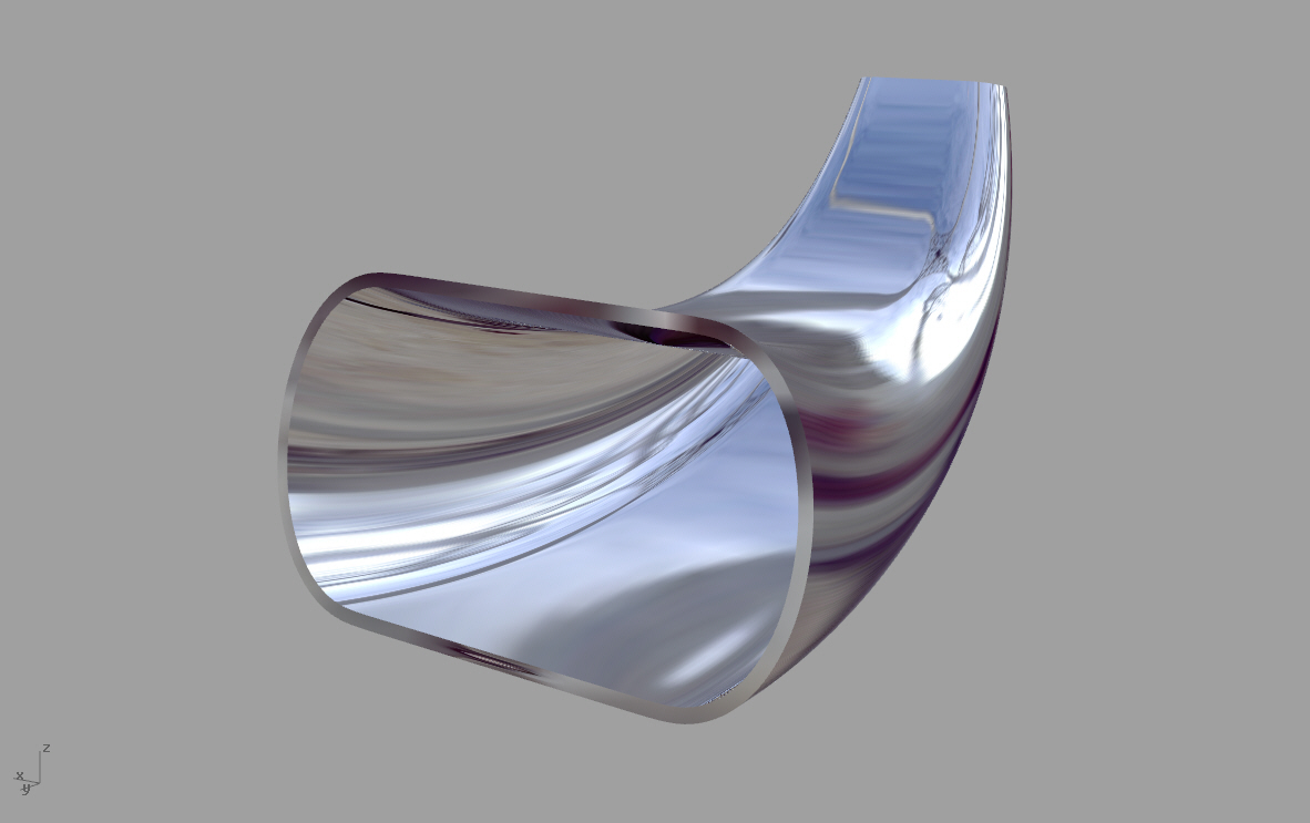

Examples from VRay:
