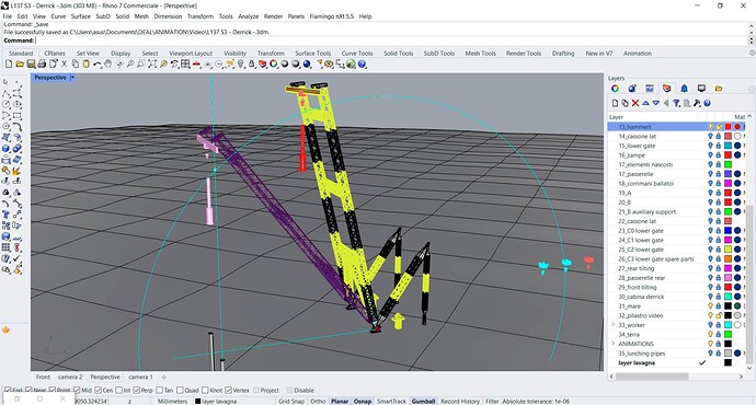

I cannot make the step solver component. I didn’t get how to animate. Isaw a tutorial on you tube where it is suggested to add a timer (now the trigger), a button and a counter which I don’t have in my Grasshopper version. Basically I have to combine 2 movements: a rotation and a traslation on the xz plane. if I run the movement one by one they works, but for this animation I must combine them. Do you have any clue how to make it works?

@martinsiegrist’s shows well how to use StepSolver if the thing being animated is one of the goal inputs.
If it’s just running a simulation without changing the goals, you can connect the slier to the Animate input of the StepSolver.
I’m a bit confused though that you say this is about combining a rotation and a translation. If that’s all that’s happening you don’t need Kangaroo and could just use a regular slider animation with the slider connected to the transformation inputs.

Hi @DanielPiker basically, if you check the image I posted, the crane has to rotate to align the upper beam to the pillars below. so the beam and the trolley don’t have to rotate togheter with the crane, they have just to traslate in xz plan. I set the crane rotation and then using the A+B component I combined also the movements on x/z axis. I thougth that use the merge and the step solver can be the best way to animate this movment. Am I wrong?
Here for example as the slider goes from 0 to 1 it rotates the box by 180 degrees and translates it 10 units in X. Right clicking the slider and choosing Animate will let you save this combined movement as a sequence of frames.
