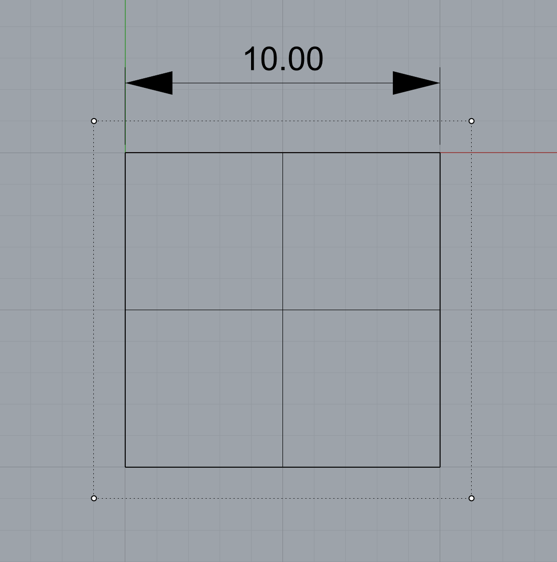

In Rhino 7 i’ve created a simple plane (not trimmed).
Then I’ve exported it to STEP format (tried AP203,2014,2014CC2).
When i’m importing it back to Rhino, i get trimmed surface.
Is it a bug or am I doing something wrong?

Looks like the problem was in the export parameters, particularly Export parameter space curves. With this param ON, i started to get correct results.
STEP_AP2014_Rhino7win_ExportParamSpaceCurves.stp (5.5 KB)
I noticed this behavior when exporting similar not trimmed flat plane (10x10mm) from SolidWorks to STEP file. When imported in Rhino7 (Win10) the surface is trimmed.
Would appreciate any information about why is this happening, and if there’s a way to avoid this behavior (exporting untrimmed surfaces as trimmed) while exporting from SW to STEP for later use in Rhino.

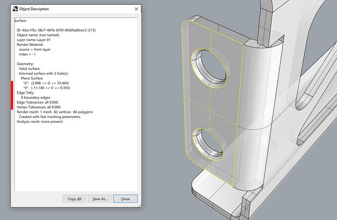

Did an experiment and opened one of the STEP files i have.
Based on your advice Jim, i found Edge and Vertex Tolerances in the Object Description.
By the way, would be great to clear one thing: is it better to check Object Description for a joined polysurface to see the “actual worst case tolerance for the edges“, or exploding down to separate surface level also works when checking the geometry tolerance?
I noticed that i get a bit different values for the same surface (not polysurface) depending on how you open Object Description window.
Object Description (right mouse button context menu > Object Information)
Object Description (Properties tab > Object > Details)
So, where is the actual tolerance?:slight_smile:

Well that isn’t different values, its just a different formatting.
Exploding a polysurface does not change the edge definitions of the individual surfaces. I would think the edge tolerance would also stay the same. When two surfaces are joined a new shared edge is created that is the same for both surfaces. When the surfaces are exploded that process is not reversed. The shared edge remains stuck to both surfaces.
If you want to find edges that are out of tolerance, you can use testMarkOTEdges
If you want to see numbers accurately in Rhino you need to set the display precision to show as many decimal places as possible. McNeel likes to keep users in the dark about things like accuracy of the geometry. The default setting for display precision is not suitable for anyone interested in accuracy.
Rhino does a good job importing its own STEP files, and geometry created in Rhino will more likely adhere to the model tolerance through a round trip. If you find otherwise, report it.
Follow Jim’s advice for reviewing the Properties - Object - Details (_What) report and usingtestMarkOTEdges.
For models that are supposed to be equivalent, you can also compare the results of _Area or _Volume. You can also use _Length and window select the entire B-rep to get the cumulative length of the edges.
