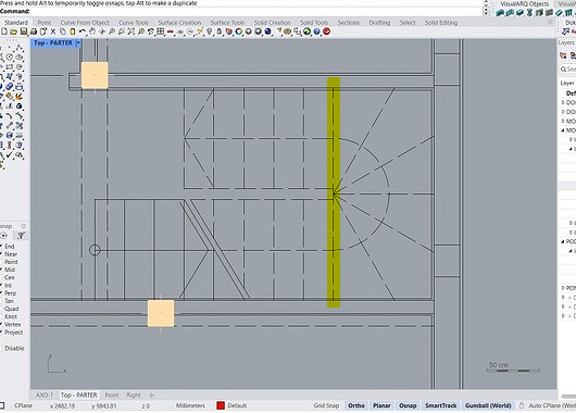

I didn’t expect I would hit the similar problem so soon :wink:
So, I need to model an existing balanced staircase, and here are my attempts:
The first picture shows the layout as it should be, I mean it is a drawing of measured staircase. The second one is a VA model. And no matter how hard I try, I cannot get a proper geometry. It seems that the model lacks (at least) one parameter - an offset for centre point. I think if I could move this point a bit I could get a more accurate model. Francesc, what do you think? Is it possible to add such a parameter? Plus a number of “balanced” steps set by a user?
Cheers, Jaro
Hi Jaro, in VisualARQ it is difficult to generate a stair that has the last and first steps before the landings completely aligned. Like in your screenshot:
The stairs are designed in VisualARQ to force a step be always a bit forward in relation to the same one in the opposite flight. This is something we plan to change in future versions.
The balanced stair will try to rotate the steps given a radius, so it might be difficult to get that result as well.
On the other hand, you can could create that stair as a non-balanced one, and just add steps to the landings (in the Stair object VisualARQ Properties dialog, after running the Properties command, or doing double-click on the stair):
