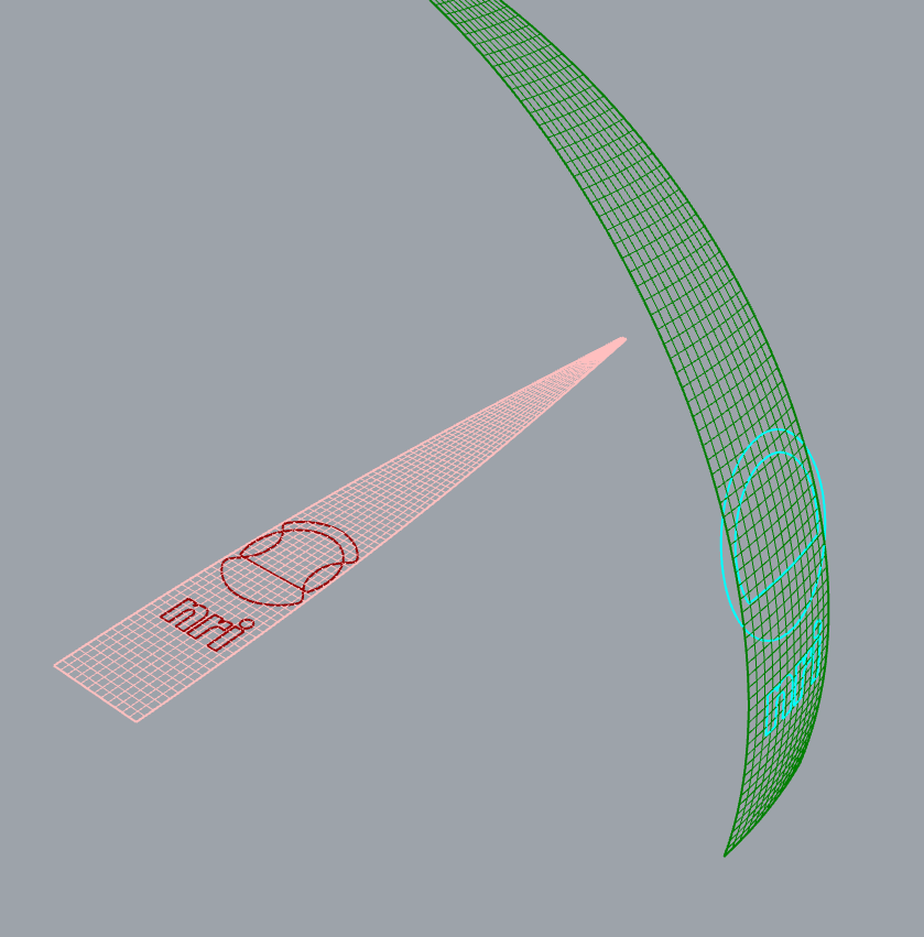

MeshCageMorph(included in the fattener.gha file here) will do that.
The geometry needs to be on or near the reference mesh to work well though. So here you might want to trim those parts that extend beyond it.
meshcagemorph_curves.gh (9.0 KB)
