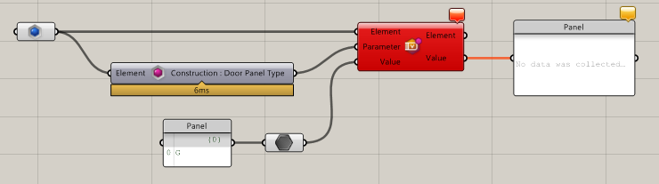

I am trying to change this parameter with grasshopper, but when I try and input a value, I get the error “Specified Cast is Not Valid.”

I’m getting a null value…
You are inputting a Type, a single instance of the family will suffice.
