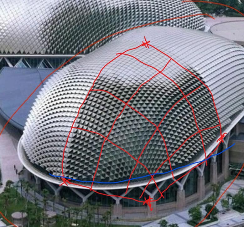

im trying to sort these mesh faces’ points so i can build triangular faces that covers the half of each half like the diagram in the grasshopper screnshot but i couldnt any help please!!

What happens when the meshes cross each other and have different patterns.
The diagram is an orthogonal grid, but the mesh is more of ellipsoidal one were the mesh squares cross each other
is there anyway we could make it like a grid like in the diagram? doesnt really matter the center when they cross!
Well since the grid changes the orientation will change
Or you want to impose an orthogonal grid on the elliptical surface

thanks sir but thats still not what i m looking for is there anyway we can achieve a perfect grid like system ?
no
here’s why
let’s start with 3 sides of a box → they look ok when unrolled
if you bring the box back together, you’ll see they cannot align
it’s because it’s a single deformed (and trimmed) surface
your algo creates this
what you need is this
so basically, you need another way to create the surface (rail revolve won’t do) and another way to divide it (quad remesh won’t do
thanks sir! do you know any way i can achieve the same thing as the building shown in the pic?

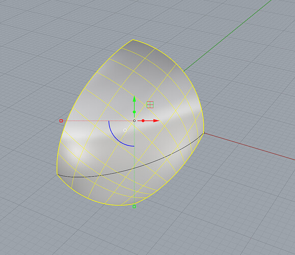

start by figuring out how to construct a regular surface like this
that when you trim it gives you the intended shape
you basically need 4 boundary curves and a bunch of sectional profiles, which you can sweep, loft, or networksrf
@amir_kharrat just to illustrate on your reference
@amir_kharrat here’s such a surface
amir_surface.3dm (546.9 KB)
perfect sir! thanks alot!!
no command. i constructed the curves manually
then sweep2
how did you get the surface?
sweep2
