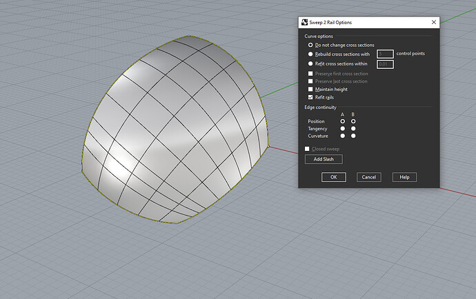

sweep2

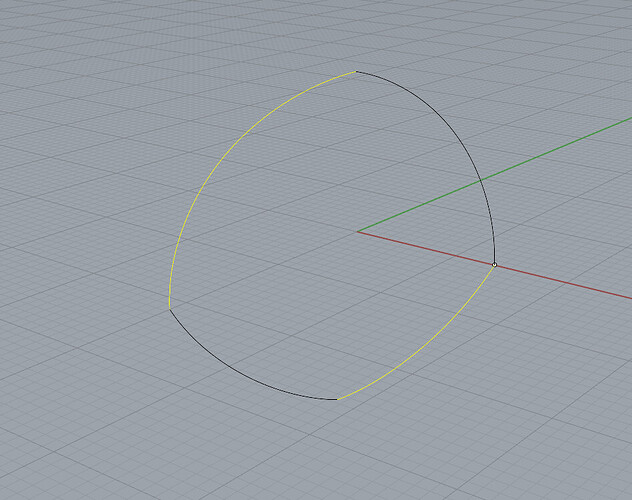

select these as rails

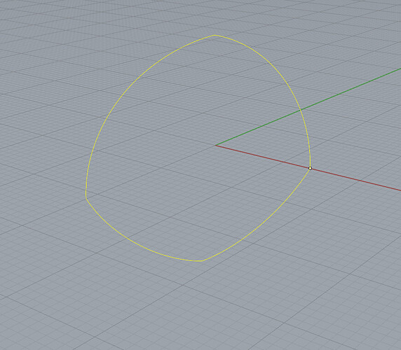

the other two as sections
press enter, and you’re done
