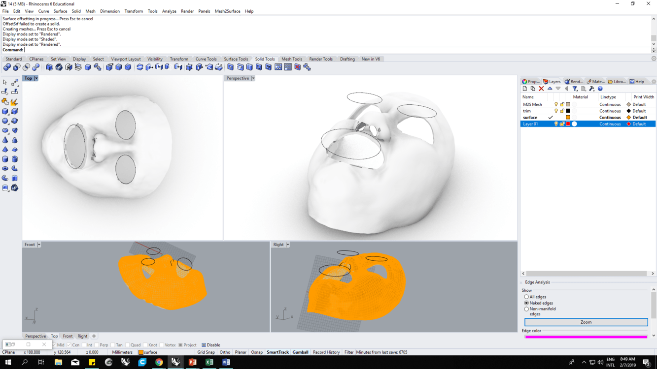

Hello i am a college student currently doing a project using a 3d scan of a face. using the plug in mesh 2 surface, i am able to make an exact replica of the face. the problem beings when i want to offset the surface. when i do offset my surface, it has holes around the nose area. can someone help me offset the surface? i will attach the original mesh and my surface to this topic. any help is appreciated. thank you very much.NYP_5.stl (7.8 MB)
I used command offsetmesh with 2mm thickness and ticked “solid” on as shown in the screenshot.

oh i forgot to say that i have to make a surface from the mesh and then offset it. it doesn’t have to offset as a solid but it must not have holes around its face such like the picture and file i have attached. why must it be a surface you ask? it the only way to be able to manipulate any bump of the surface of the face. when i consulted my supervisor, i was told that i had to go from mesh>surface>offset surface. that was the reason why i stared using the mesh2surface plug in trial version. it sounds easy but i just cant seem to offset it without any holes forming. please help a soul out. thank you.
by the way, this is how my final product should look like, but just without the holes. the holes are due to the offsetsrf.

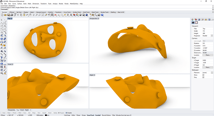

Hi again, while playing around with the method you have described, i was able to model it out the way i wanted. However, i cannot seem to fillet the edges at all. i want to fillet it a tiny bit ( maybe just by 0.3mm on both sides )to smooth out the outer edge. Is there any way to do so? I can’t seem to upload my file no matter what format I put it in so, I have attached a picture of how it looks like.

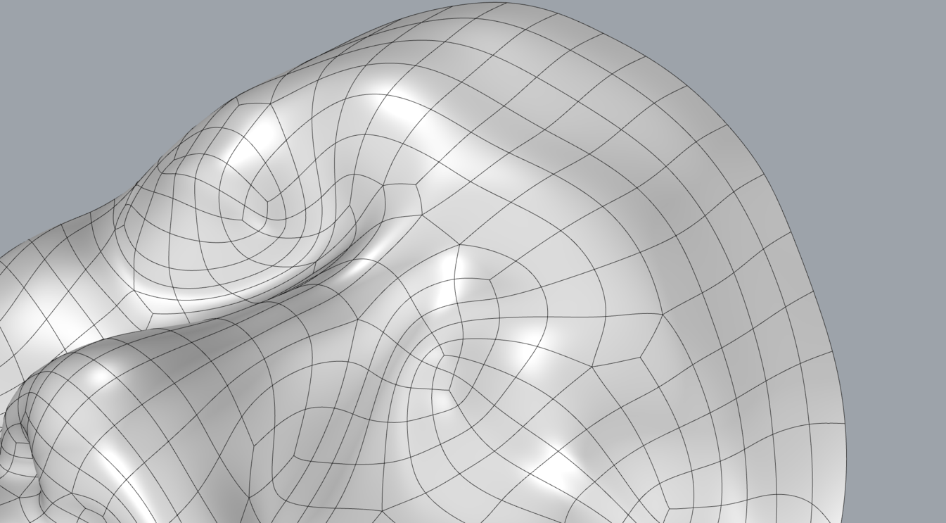

Here is an example of the file that you did send.
  1. converted to Interpolated SUBD using the quadremesh. (1500 target, 50 adaptive, everything else off)
  2. Use the ToNurbs command to convert the mask to NURBS polysurface.
  3. Boolean the pads to the Polysurface.
  4. Use the Fillet edge command to get a .3mm fillet.
Be aware that the small features ou are looking for may demand the tolerance in the file is lowered. I lowered it to .0001 mm. I like to have a tolerance 10x smaller then the smallest feature I am concerned about.
You can keep driving down the number of Quad faces with by using and adaptive size of 0. In this case I use 750 quads:
Using curves around the eyes and mouth would help the definition in those specific places.
If I use guide curves around the eyes, I get to here:
Hi. Sorry if I was not clear but, It is not the feature i want to fillet but the edges/parameter of the mask itself after offsetting, lofting and joining it…
