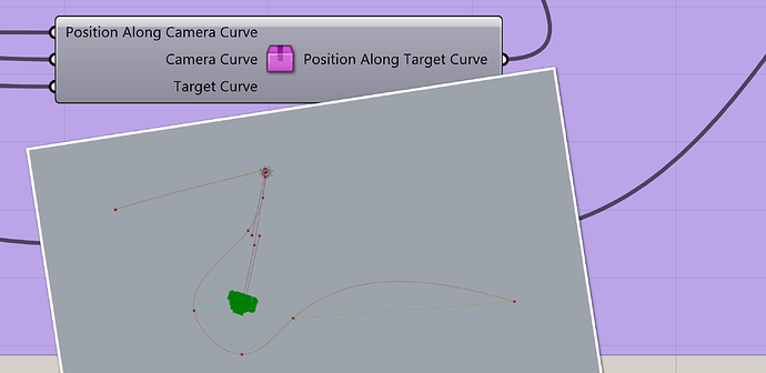

  2. Key frame alignment:
    The screenshot is from the third animation, flying through the hyperboloid towards the tree. I defined a target curve, which is a polyline, and a camera path, which is an interpolated curve. The two curves have the same number of control points. While the camera moves along the camera curve, the target moves along the target curve. This component outputs a position along the target curve so that the camera and the target reach each point at the same time. The points act as key frames.
    In the screenshot, the red curve is the interpolated camera curve. The purple curve is the target curve. The cyan line shows the direction the camera is looking.
    Note, I made little changes inside the cluster. Therefore, animations rendered might look slightly different than in the video above.
    Again, thanks to @Jakob_v_Schirmeister for showing how to make this work: Parameterize two curves to match at control points
