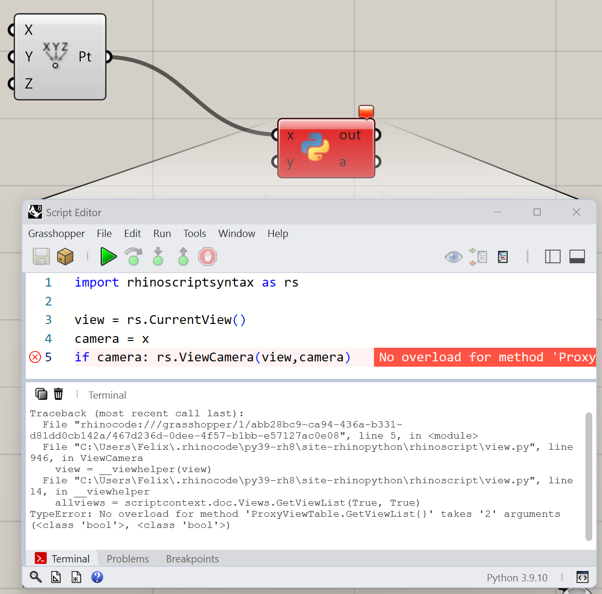

I am following a video tutorial on how to control the camera from Grasshopper in order to create a fly-through animation: Control and Animate the Camera with 6 lines of code GH Python Rhino 7 - Beginners Tutorial - 002
Unfortunately, I get an error message when trying to set the camera. Here is a simplified example:
2025-06-05+02_no_overload.gh (6.8 KB)
How do I make that work in Rhino 8’s Grasshopper?

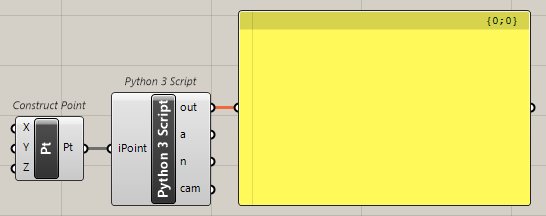

cameraScriptManipulation_1.gh (11.6 KB)
but it behaves strange…
better.. sorry
cameraScriptManipulation_2.gh (12.7 KB)
Works fine without it through, thanks.

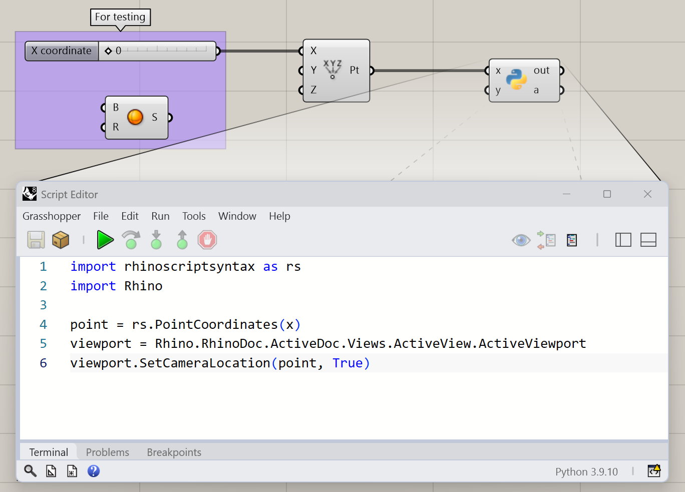

Thank you, that pointed me in the right direction!
Here is what I have now:
2025-06-05+02_no_overload_fixed.gh (6.4 KB)
The conversion on line number 4 would not be necessary with a type hint in the input parameters. But I prefer to have it all in code for this example.
