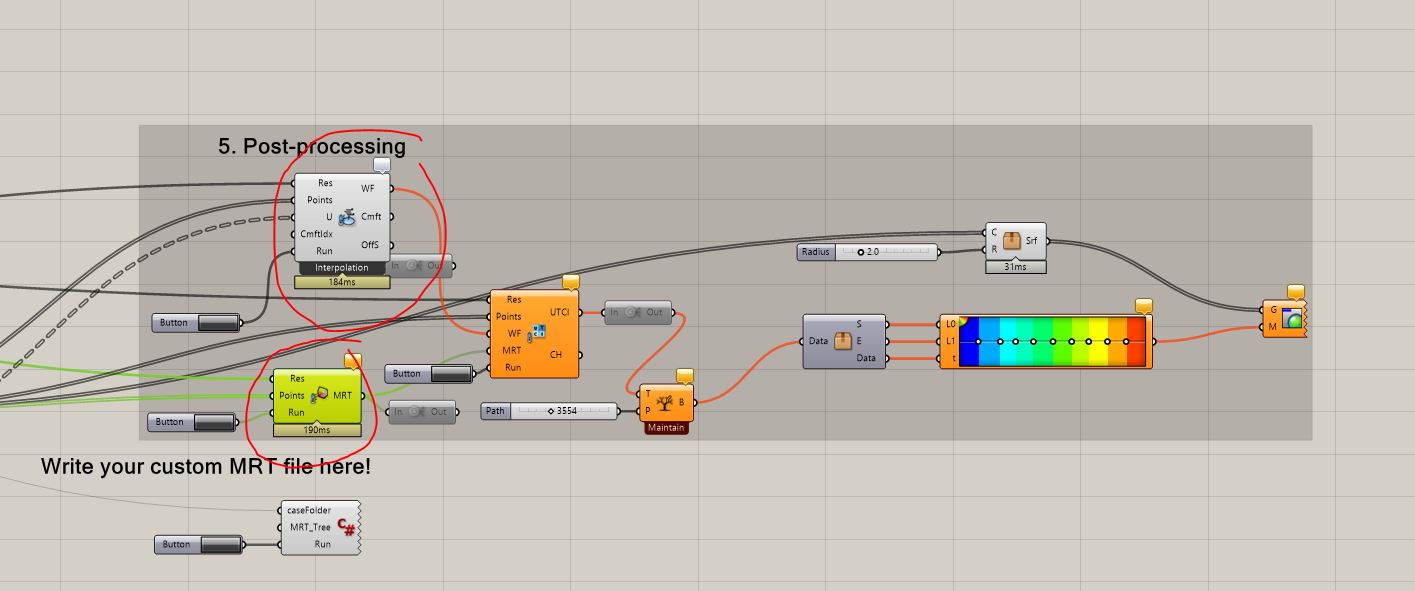

Yes @trumori have the same issue. I installed radiance in Drive C as instructed but When MRT component is toggled rhino crashes

I do encounter the same problem. The MRT component crashes GH and Rhino, and this happens on the Annul Wind Study template definition as generated with Eddy3d. I tested this on 2 separate PCs.
What could be causing this?
Thanks,
Andrea
I am wondering if there has been any progress in attempting to run the MRT component without GH and Rhino crashing? Any insight would be much appreciated!
