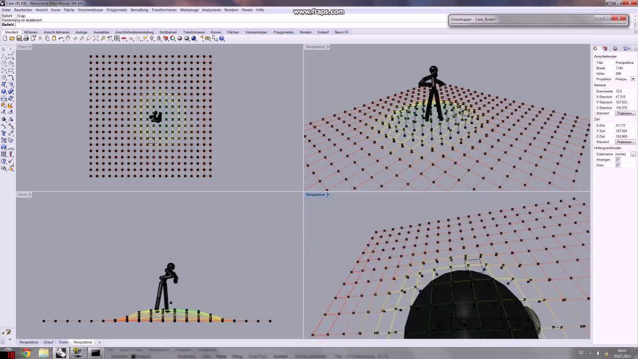

I need a simpe human body that will works with sliders. I want to use it for an basic animation on Grasshopper. At least even the example below works. How can I do it? Thank you in advance!
a simple example

The ‘poseable human’ definition from here might help?
Thank you all! @DanielPiker’s solution is very helpful. Unfortunately, it works with Kangaroo’s “grab” component, in other words with dragging left mouse button, not with sliders. I am not similar to Kangaroo, so I am not sure if I can control it with sliders instead of dragging.
