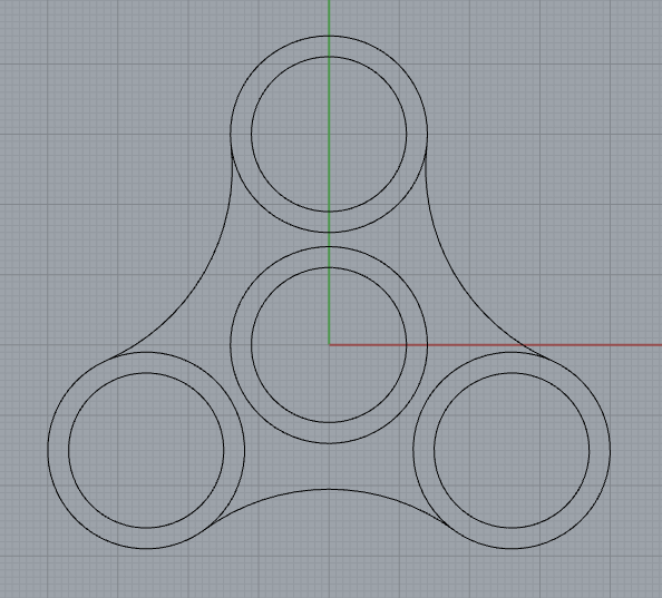

Hi Jerold - if the shape is essentially 2d plus some thickness, you can pretty much to all the work on the curves, then just ExtrudeCrv. I used ArrayPolar to evenly distribute the circles. Basing the design on the origin makes it all more convenient.

Hi Jerold - I used Fillet to make the big arcs once the circles were arrayed. Radius of 30 or so.

When I use CurveBoolean, I notice I have to delete some extra curves to get down to a single one. Is this normal or am I running CurveBoolean incorrectly?
After Fillet then CurveBoolean, I end up with a closed polycurve around my spinner.

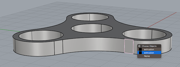

When I ExtrudeCrv, My edges become exploded. I feel like I have done something wrong because I am clicking on many edges to FilletEdge.
I am also noticing two extrusions along the outside. What are the outside small rectangle extrusions by each hole?

Hi Jerold - watch the command line options for CurveBoolean - there are options for what part of the input to delete - probably you want ‘All’. Multiple edges is normal - there are multiple faces in the extrusion, so to speak, where you see the vertical edges. Use ChainEdges > AutoChain=Yes to reduce clicking in FilletEdge.
My guess is the extra extrusion was from a stray curve that was selected.

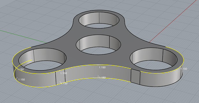

Hi Pascal,
Looks like Fillet caused the curve to break into three parts. That may be where the extra extrusion came from. I posted a screen shot. Is this normal or did I do something wrong when I filleted. The two lines were one piece until Fillet was ran. I am going to Join them and redo the extrusion.
