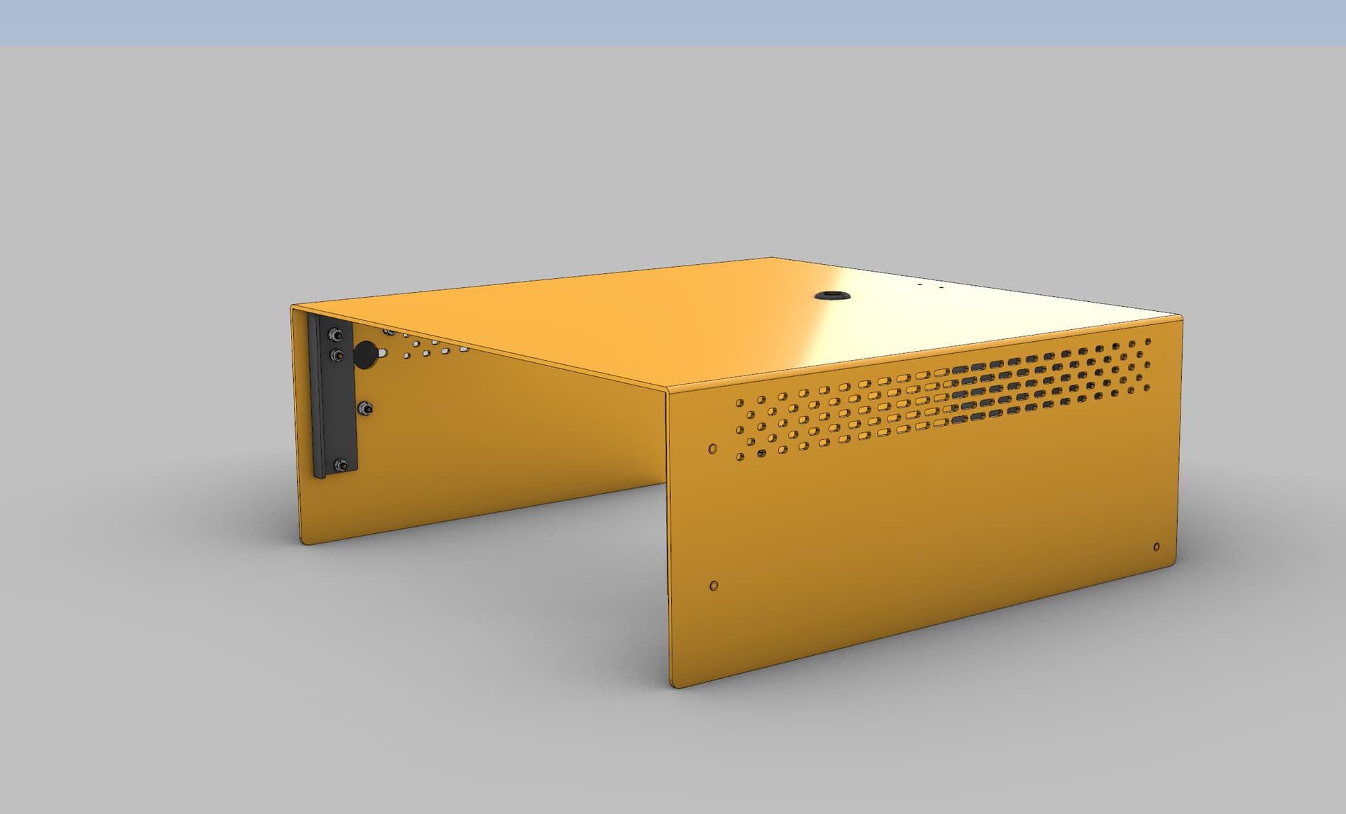

I’ve been putting together a bit of a home studio, and just finished a little project making a custom desktop audio rack for all my gear. I bought a similar one on Etsy, and…immediately decided to make a fully custom version. I wanted something bigger, so that my headphone amp and DAC could fit underneath. I wanted it to have an enclosed back, since the back of my desk is visible from my deck and I hate looking at exposed wires. I also thought it would be super slick to incorporate a microphone boom mount directly into the side, for super clean wire routing. Lastly - the one I bought had a ton of visible fasteners on the outside, and I wanted it to be as flush and clean as possible. I mocked it all up in Rhino:
I used a gh script that I got from Ray at Handlebar for the side vents. At the suggestion of the folks at Fabworks in Ventura, we used press fit studs extensively in the design. These worked out amazing, came out nearly invisible in the final product. I even used them for the hinge for the back access door. The rest of it is all just Amazon/McMaster hardware bits - a magnetic catch and leather pull for the door, 3U rack rails, mic boom and side mount etc. The sheet metal work was all done by Fabworks, and they did an amazing job. With other services (SendCutSend) if you want to do bends, you have to do the flattening yourself, and then tell them where the bends should be. With Fabworks, you just send them a solid model of what you want the final dimensions to be, and they make sure it all happens on their end. Once I got the sheet metal from Fabworks, I had a local shop do the powder coating, then it was just final assembly with hand tools. All in all, a very simple but fun project.
