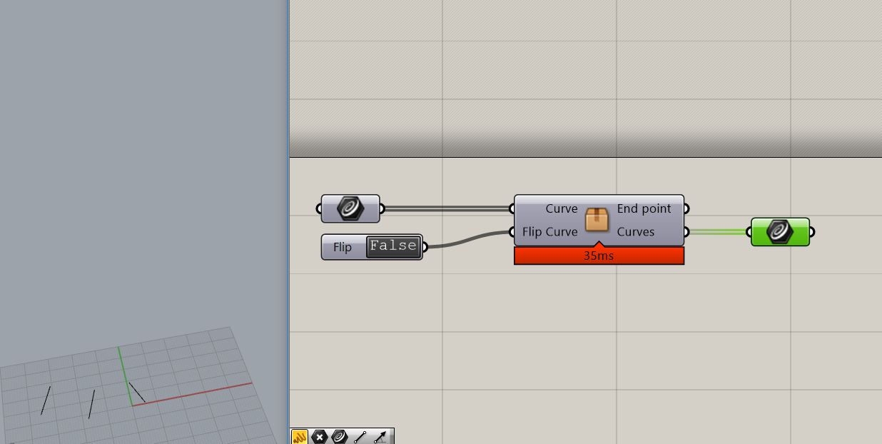

Sharp fillet question
Hello
is there any component to create sharp fillet? i create one and i want know if already exist or not.
I think it work fine now
I use script created by Giulio Piacentino to check if point is on curve
and “trim curves with points”, a very useful component from Pufferfish
sharp fillet.gh (18.8 KB)
This is my try with champer and fillet distance options.
Fillet Lines.gh (20.5 KB)
nice work
you need add option to like in rhino :
12
Update
Fillet Lines_v2.gh (22.9 KB)
much better
you can also do something like this, for a case with a line and a curve:
linesfillet.gh (28.6 KB)
then fillet from that point like you did already
Thank you
I hope someone can make a component
Many simple tools are missing and they are not difficult to created
In the case of these curves, more parameters are needed to solve the problem … It seems like the need for a component and a code editorSHARP FILLET2.gh (26.8 KB)SHARP FILLET-exp.gh (36.5 KB)
