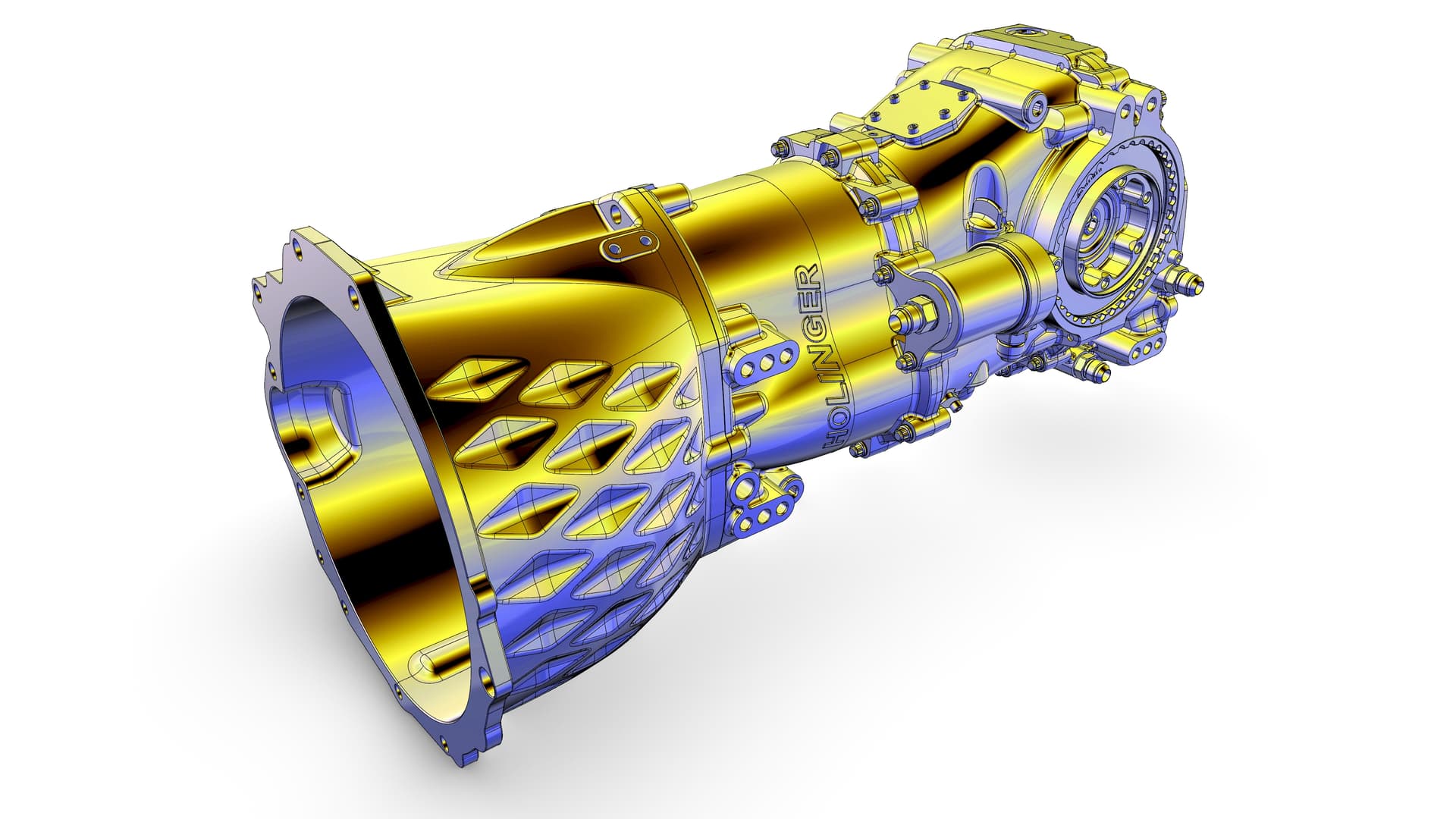

I have two display modes that mimic a bronze material. They could be also made into materials. This is just a plain environment map, no scratches.
Bronze 2:
Bronze 2.rar (5.2 KB)
Bronze 3:
Bronze 3.rar (5.6 KB)
Bronze 4:
Bronze 4.rar (5.6 KB)
Same as Bronze 3, except that the background colour is changed to RGB 85, 111, 134.
A basic material using the Bronze 3’s environment map. Works great with my Bobi 1 display mode optimized for the best performance:
Bronze 3 material.rar (5.1 KB)

Additionally, you can try the following:
Bobi X17.ini (13.9 KB)
Bobi X17 with the parts using SetObjectDisplayMode set to Bronze 3:
Bobi X17 with Bronze 3 material:
Bobi X12 delivers a similar result, except that it uses less contrasty shadows:
Bobi X12.ini (13.8 KB)
