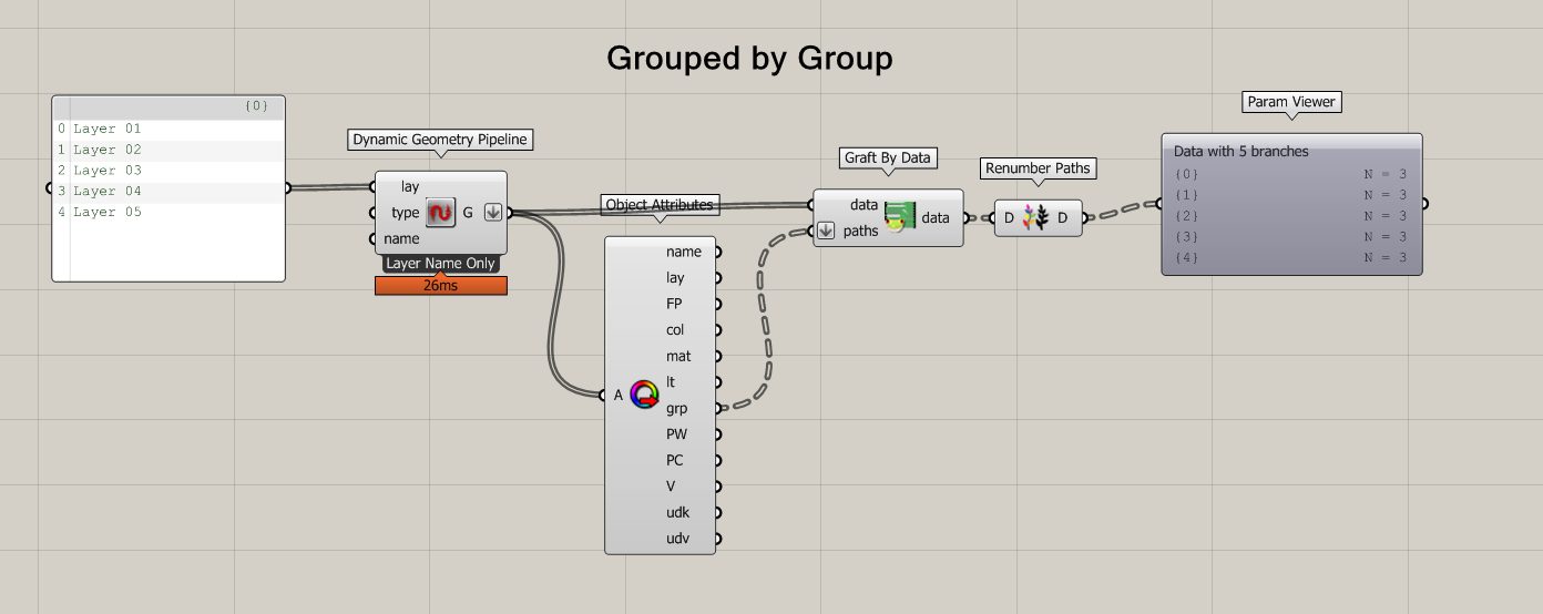

Human will allow you to sort by Rhino Groups. You will need to learn how to work with trees tho.
You can extract outline / boundary curve of group like below:
Like in this thread:
thank you, “human” helped me a lot, as boundary is only closed curve in group I extract them with “closed” and “dispatch”
